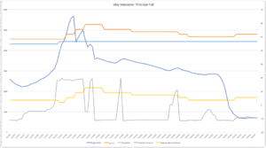

My eBay forge knock off data from this morning...

Old Nov 10, 2017 | 06:06 AM
scotty_r56s's Avatar
scotty_r56s
Joined: Mar 2014
Posts: 642
Likes: 201
From: GA
Looks pretty consistent. I'd imagine multiple pulls back to back would mirror my data. I'd say we both got a hell of a deal!
