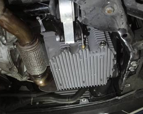

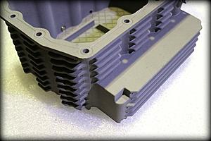

Found some info
Found this on a Peugeot 208 forum. It looks like the baffling isn't very significant.
http://www.208ownersclub.co.uk/forum...topic4188.html
"I found this from Wortec that was made for R56 Mini, owners of 208 GTi in Taiwan told me that this is a perfect fit. Hold 0.5L more oil and fins help dissipating heat a little more, also there is baffles around the oil pump. There are also some pre-drill holes for sensors, return line from the catch can and extra oil cooler.
But the bad news is that they're very rare nowsdays, I found no reputable online shops have them anymore. I barely managed to find one from a Taiwan dealer with a taiwanese friend's help."
I found this Moroso baffle for a Honda S2000....couldn't find anything from Moroso that would fit a MINI. Checking with Summit and Moroso to determine if this baffle could be modified to fit out engines.
https://www.summitracing.com/parts/MOR-23040
Attached Thumbnails Wortec finned oil pan. Anyone have experience with these?-wortec-oil-pan.jpg   Wortec finned oil pan. Anyone have experience with these?-wortec-oil-pan-2.jpg   Wortec finned oil pan. Anyone have experience with these?-wortec-oil-pan-3.jpg

Vivid Racing contacted Wortec. Wortec's response-
"Here is the info I was provided by Wortec.
Approximate 1.8-2cm ground reduction.it adds approximately 0.7-0.8 quart.
The final capacity also depend on if he's running any external oil cooler.
Please let me know if you would be interested in a quote. "
I don't have much ground clearance as it is...will have to measure it, but 3/4 of an inch might not be possible for me.
