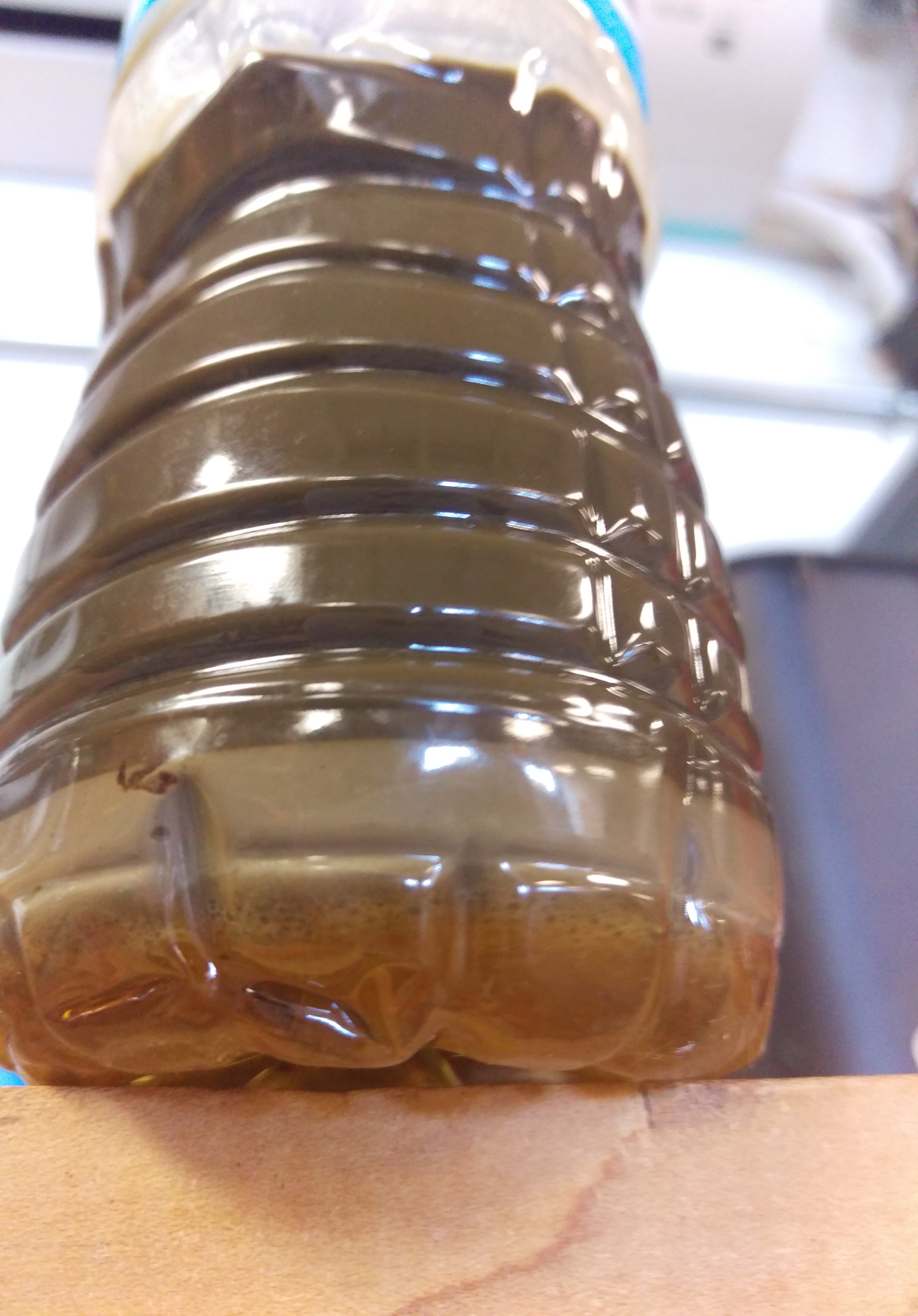

Not even two whole months and between the 2 oz or so I got all over my hand and transmission yesterday and the 4 oz of I drained out today there was easily 6 oz of ... combustion by-product collected in the OCC and man, I've dealt with some nasty, crazy and dangerous materials in my life but this **** is gross. It's like a soft green, kind of like mildew.. there's bubbles in it but they don't float, they sink.... the smell of it permeates your skin (which means I will be wearing surgical gloves from now on), it's just gross. I didn't snap a picture todays been a helluva day for me, we will see what it looks like after being allowed to "settle" over night.
I purchased the "monster" sized OCC, it was no where near full, I guestimate that there was 6 oz in there after just two months, the monster OCC has 32 oz capacity, It's a BIG can. A little more difficult to make it fit but it can be done.
