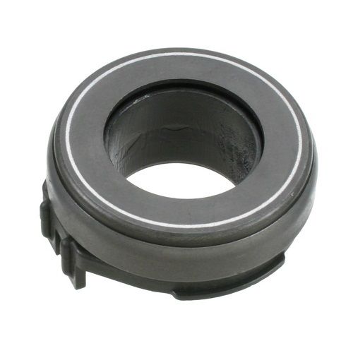

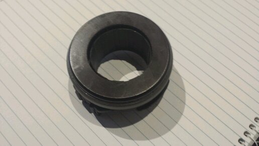

Hey gang, I got the Valeo SMF and clutch kit. The throwout bearing included in the kit, there are 3 plastic tabs on either side and one of the 3 on one side has broken off during transit.
There's confusion if this throwout bearing is unique to Valeo or an OEM MINI part. They look completely different. Can I use a standard OEM MINI throwout bearing for the Valeo SMF clutch kit?
Also, not included in the kit are the 2x driveshaft nuts, are they OEM MINI as well? I also need to replace the steel guide sleeve and "Thrust bearing"....isn't the thrust bearing the same as the throw out bearing?
I need to get all the parts sorted for my mechanic before my scheduled hoist time in mid July.
First pics are of the OEM Mini Part, 2nd set of 2 pics are of the part I got with the Valeo clutch kit

First question, where did you get the kit from? Did you order it online and have it shipped to you? If the part was broken during transit to you, I would call whomever you ordered it from and have them send you a new one.
I am unsure if you can use the OEM MINI release bearing. The question in my mind is that if the dimensions are different for the solid flywheel conversion the release bearing might be different than the one specified for the MINI equipped with the DM Flywheel.

I got the kit from Bavauto. I called them, they called Valeo and Valeo said it was OEM MINI. I called Valeo to clarify and they said it was OEM MINI also.
Does anyone know for sure if the dimensions are different between parts? I don't want to stick OEM parts into the SMF conversion kit and it tear itself apart.

I found the same Valeo kit on eBay and it looks like it has an OEM MINI throwout bearing. I really need help confirming this as my booking for the clutch job is coming up soon and I don't want to put a bad part in and tear up another clutch or possibly do more damage....

Well that is good news then! If all companies are saying so then you should be alright. Believe this is the part number you'll need: 21-51-7-547-077
