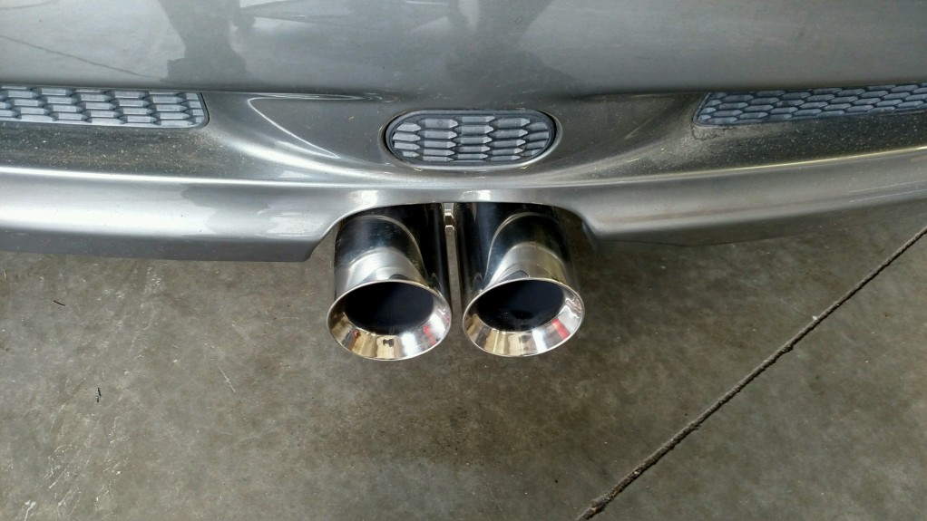

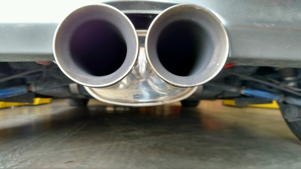

Hey guys, did a custom 3" exhaust, vibrant muffler, ss pipe and vband clamps. What do you guys think?

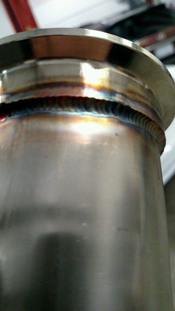

All tig welded at 65amps

Sweet let's hear it, didn't know you could do a straight through on the r53

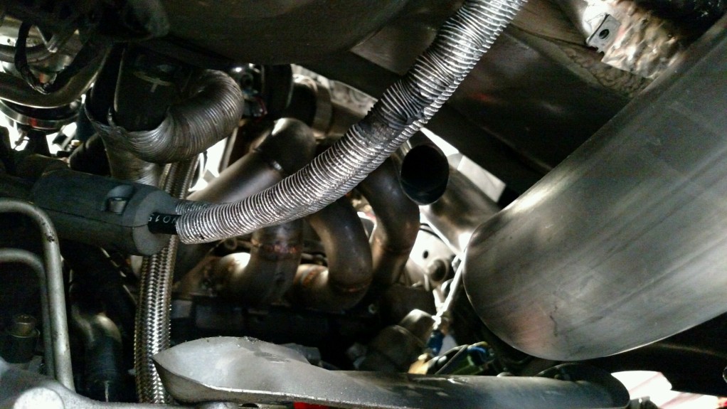

Guess I should've posted this with it :smile:Name:  PART_1428967187935_IMG_20150326_132213095_zps3adc9d16.jpg

Guess there's a bit more going on here.

Oh yes, you can certainly do a straight-back on an R53, and without removing the battery box, just go right under it (yes there's room, even on a mildly lowered car). I know, I've done 14 of them, in multiple muffler/resonator/glasspack configurations. You'll find an honest >10 HP if you do it right.
Unfortunately, without a turbo chopping those exhaust pulses into tiny bits, it'll still be CRAZY loud.

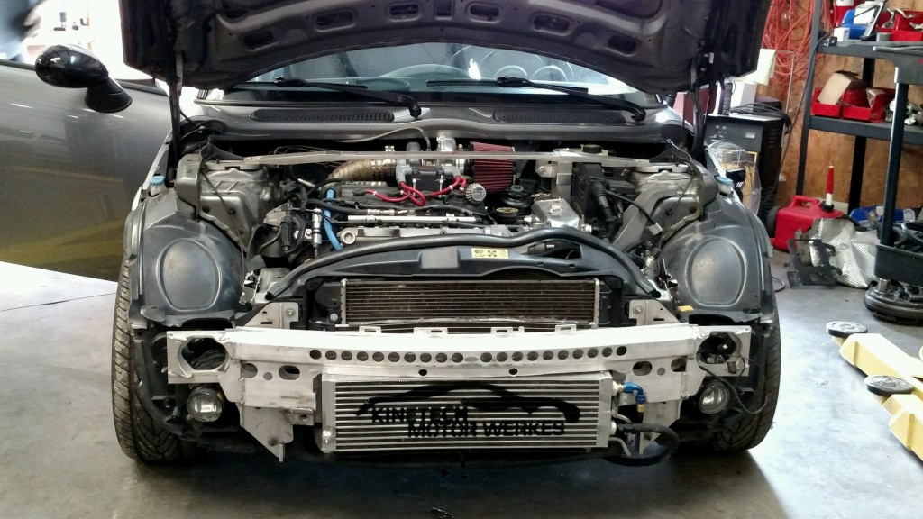

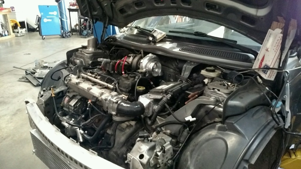

This is actually our shop car, we're a small independent MINI/BMW shop in indian trail,NC called Kinetech Motor Werkes. I really don't want to put to many details out, seeing how it's still a work in progress. Here are some more photos though.

I was gunna say in that vid that isn't a normal sounding exhaust.... and you showed me alright.... helps when there is a k04(I assume) size turbine spinning

Do I spy an external wastegate?
Old Apr 14, 2015 | 12:20 PM
mtechnik2's Avatar
mtechnik2
Joined: Apr 2015
Posts: 62
Its a 3071… and yes, turbosmart external wastegate, with a custom open dump.

Flagged V band weld

Purdy! do I spy a w2a?
