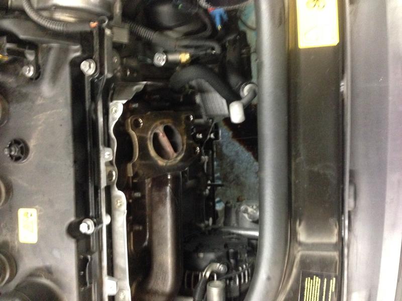

There was actually closer to 4 part numbers and Realoem comes up wrong with since some part numbers ended or superseded to different part number. They latest JCW manifold has square long runners and uses better casting methods for much smoother "as-cast" appearance.
Out of the box the JCW manifold is the best hands down, you can tell by looking at the photos of them on WMW website that MINI engineers put some time and money into developing a JCW manifold.
The debate comes with the "ported" n18 manifolds. Sure its larger and 2 lbs heavier due to older casting methods used. It is also about $100 cheaper than a JCW manifold and I would think a little easier to get a hold of used if you are just going to port it and ceramic coat it for resell.
The only info I have seen about ported N18 manifold is about how the volume of each runner can be increased to be larger than JCW manifold. Volume and flow are not the same thing. So until flow numbers are produced we still like the JCW manifolds. Think of it like a ported cylinder head you can put the largest ports in the world on it but if your valves are still small it's gonna dictate how much of it is usable etc etc.
Here's a pic of 2013 JCW stock manifold and you can see the quality just in the external finish.
