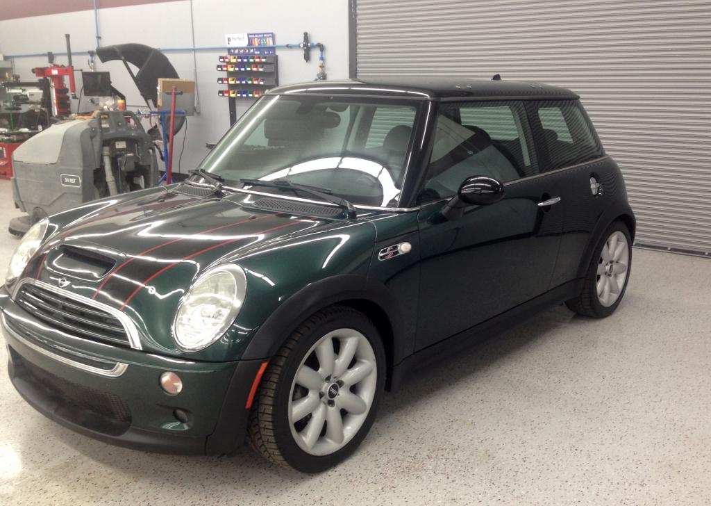

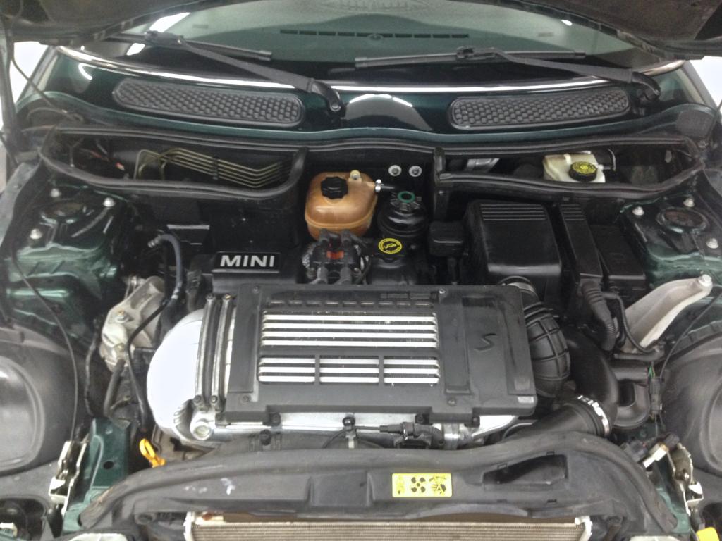

Hello everyone! Meet Olivia (means Elf Army!). We call her Olive for short! She is a 2004 Mini Cooper S R53,we imported her from Italy. She is going to be a street legal go-kart! Olive will be daily driveable, functional and reliable. Oh did I mention she will be mental fast!
The Plan:
We are going to make her into a 1.8L stroker engine with a C38 Rotrex supercharger!
Here she is in stock form!

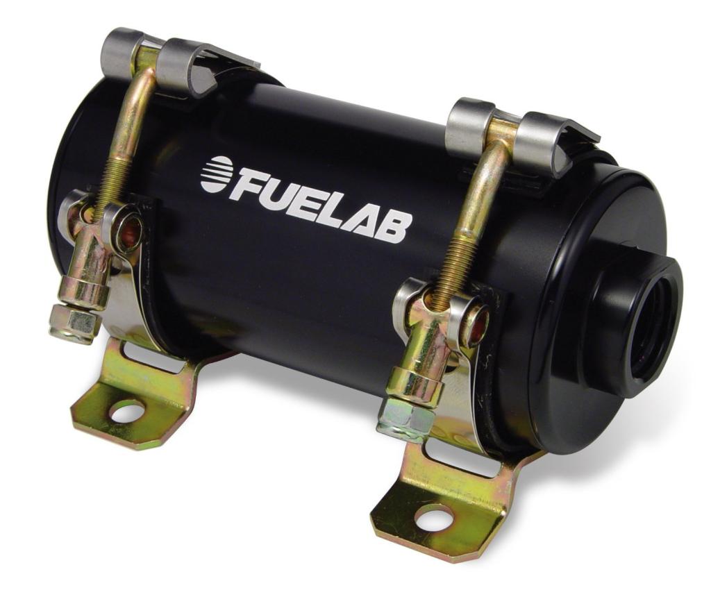

A fuelab 41401 Prodigy external pump will be controlled by the Vipec ECU. A 75 micron pre filter and a 40 micron post filter will be used to catch any contaminates floating around in the tank.
Pump

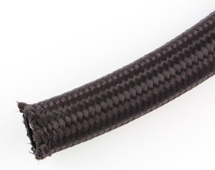

Tying the whole system together with Fragola -6 braided racing hose and a fuel regulator. I will also be running a return line; splitting it with a Y-fitting feeding both tank lobes with bulkhead fittings in the top of the tank. Stainless braided line will be used around the tank to prevent any rubbing through.
Nylon braided line

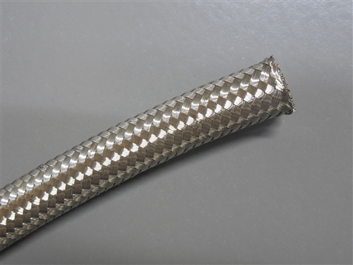

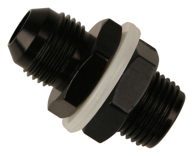

Bulkhead fittings for return.

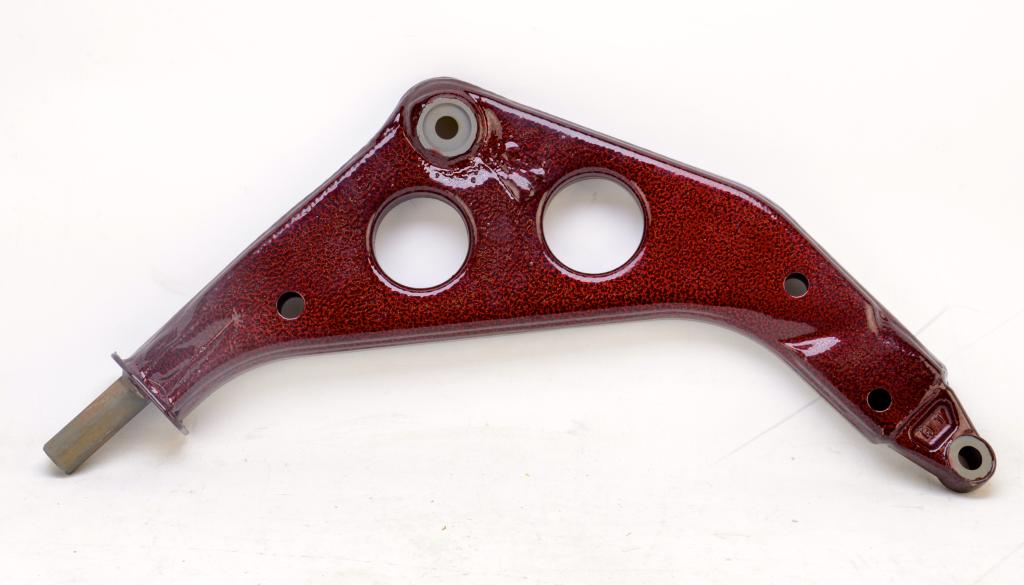

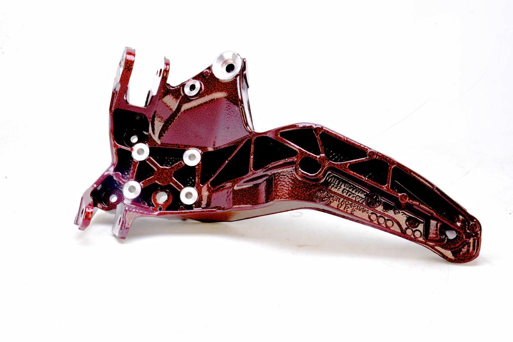

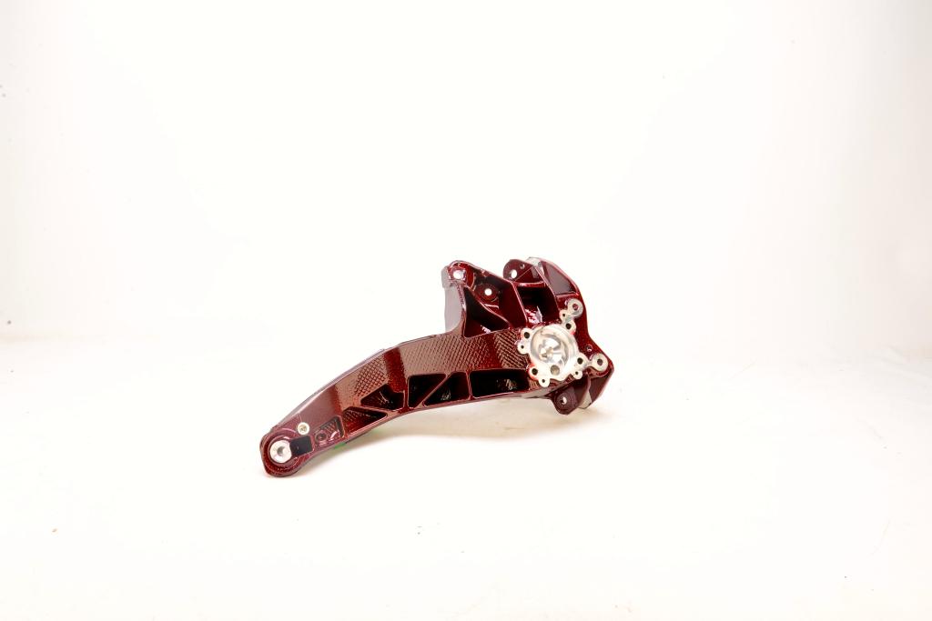

A sneak peak of the powdercoated bits! Enjoy!
GP trailing arms!
Control Arms!

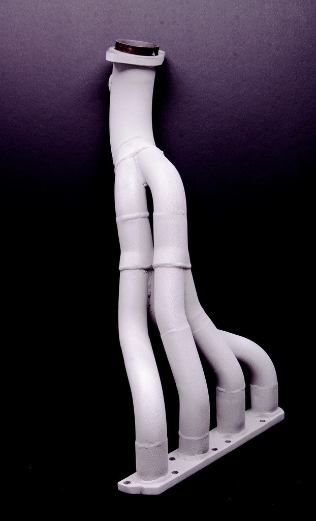

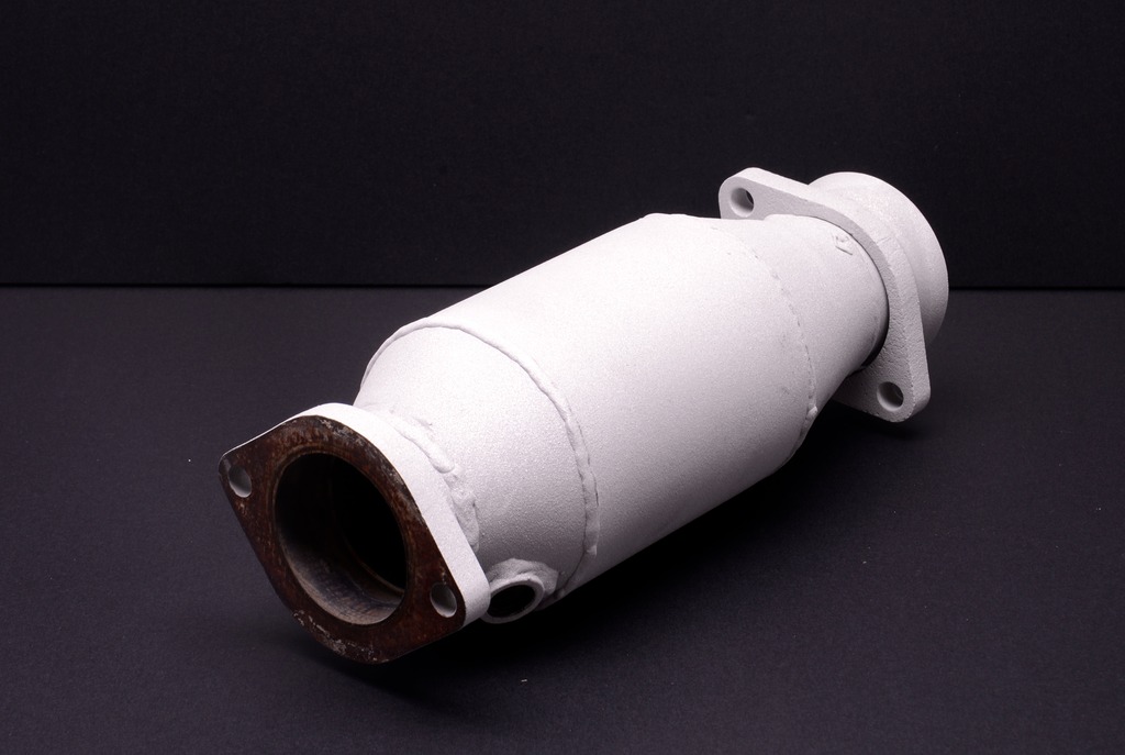

Just got my Supersprint header and race cat back from getting ceramic coating. The coating is “White lightening” from Swain Tech. It is a true ceramic heat insulating coating. It is rough and porous feeling just like a ceramic pot with a thickness around .015”.
I’ve used this coating in a few different applications with surprising results. I coated my diesel truck’s complete exhaust system from the headers, up-pipes ,turbo, downpipe to the middle of the exhaust down the truck. I’ve seen 350-400 degree drop in surface temperatures on the pipes themselves with my truck. It helped immensely to diminish the under-hood temps. Keeping the heat inside the pipes I saw a dramatic decrease in turbo lag due to increase drive pressure on the turbo!
I am hoping in this application to:
-Reduce under hood parasitic heat transfer.
- Increase the scavenging affect:
After heat has performed its function in the combustion chamber, it travels out the exhaust port and into the exhaust header or manifold. If the gases are allowed to cool they lose velocity and the scavenging effect is reduced. By insulating the exhaust system, gases inside are kept at the highest possible temperature resulting in greater exhaust gas velocity and higher efficiency.
I will be fastening the header down with a set of Stage 8 locking manifold bolts!
Supersprint Header and race cat:
Stage 8 locking fasteners
