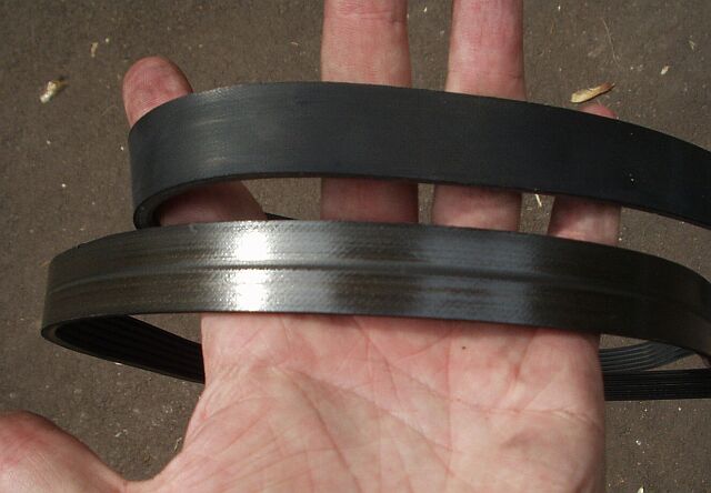

My belts wear evenly, but they seem to stretch and lose contact:
