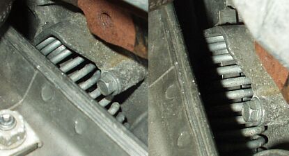

Old belt / new belt:
More belt and tensioner pics here:
https://www.northamericanmotoring.co...ad.php?t=22199
