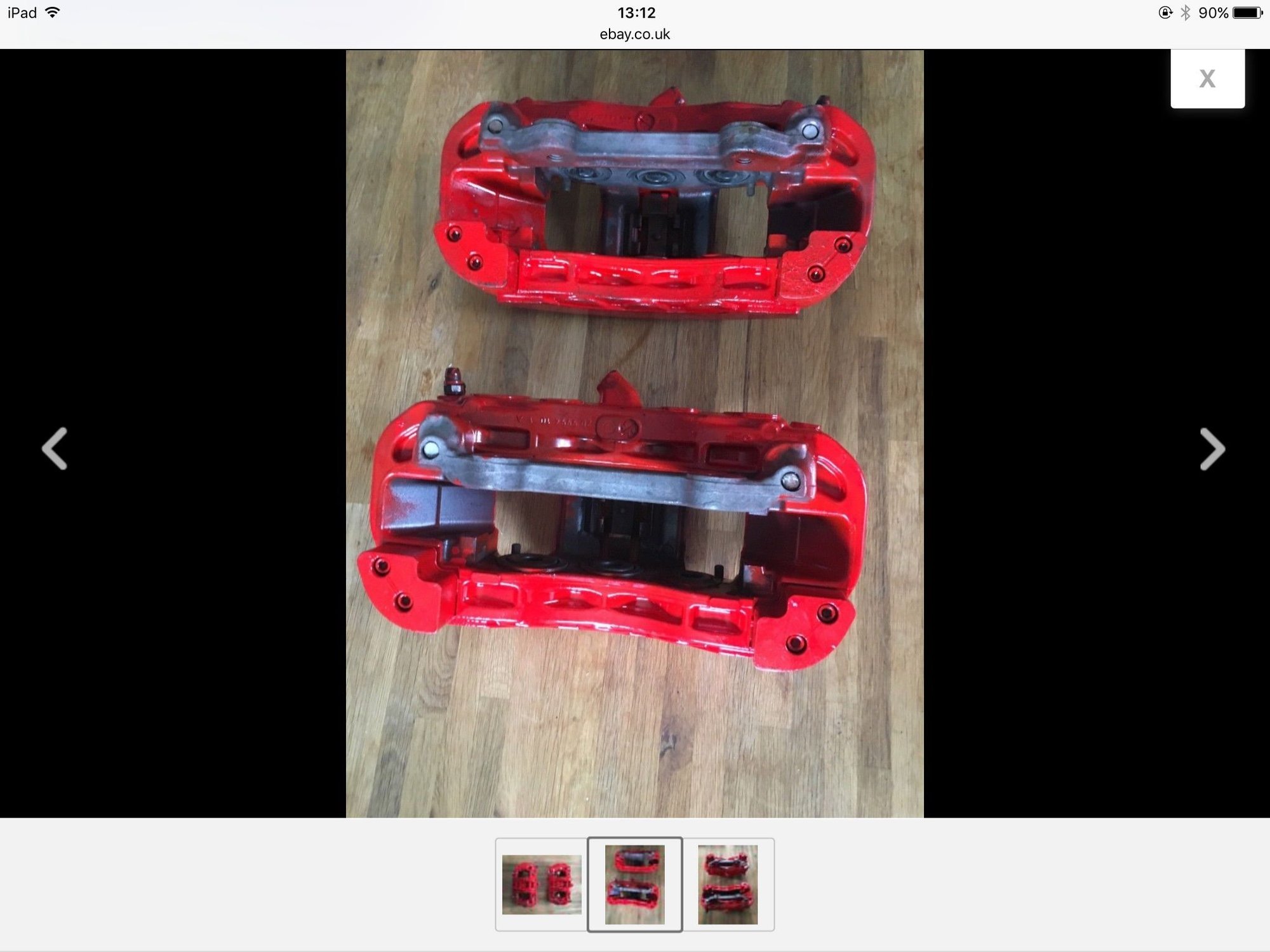

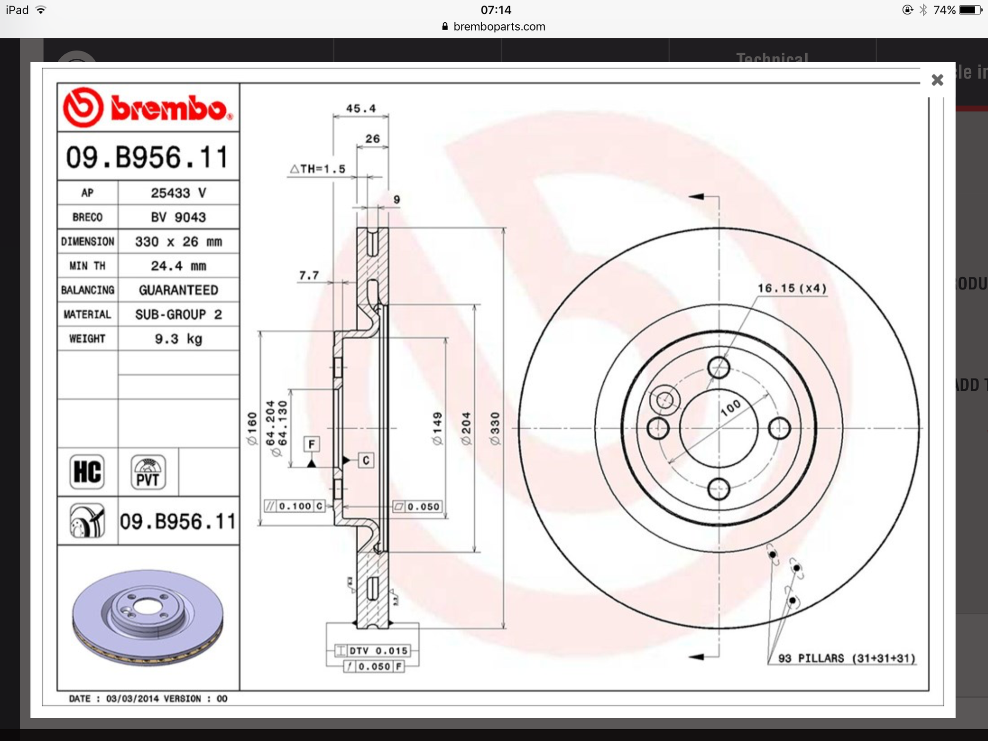

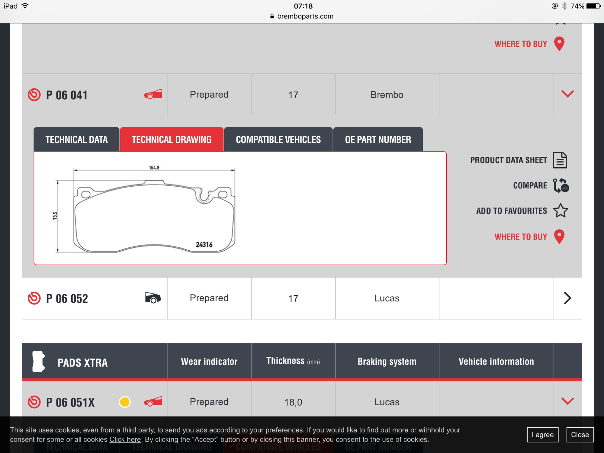

I'm looking to go down the same path soon with my roadster
so started digging for more information https://www.bremboparts.com/europe/e...gp/000057564-1
Useful info if looking at 2part discs
Also listing of bmw pad numbers
