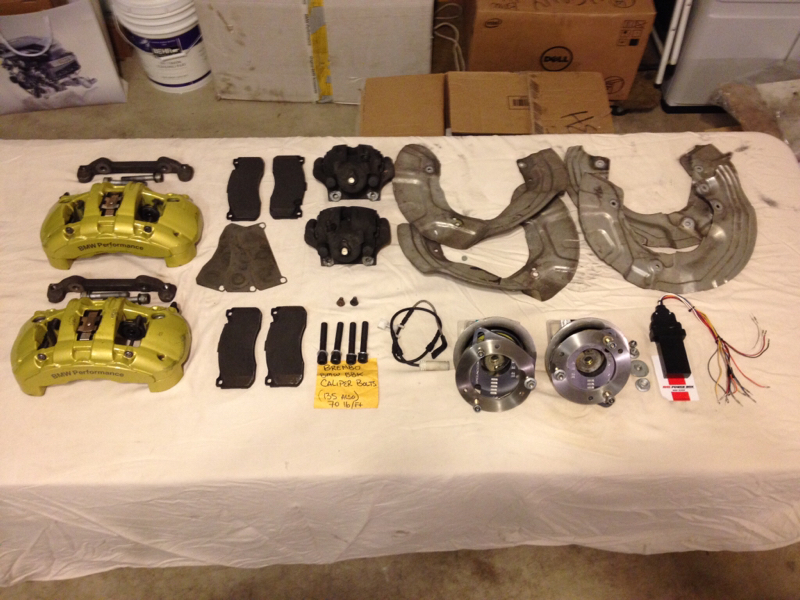

On a side note and not thread jacking really. But I have a set of BMW Performance calipers ( the yellow ones sold as an upgrade for 128 owners ) for sale if anyone wants to partake in this mod.
Please don't respond in Mandy's thread just message me. For those that don't know what I am talking about see pic.
Manny you have to follow up and tell us how they feel.
135i Brembos (Same as Mini GP2s) upgrade thread.  Dump info in here!-image-3115171732.jpg
Pay no mind to the other stuff on the table. That's just what I took off my 128 when I turned it in.

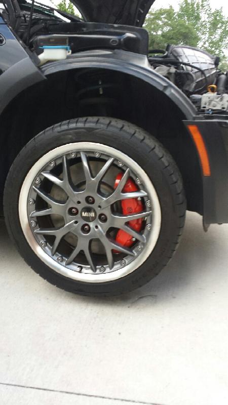

I forgot to say, I added some stoptech aluminum pistons to replace the stock pistons. Everybody told me that the ceramic hats on the brembos go to the shi[insert "tt"]errs. Ill put the part numbers for those late on, or the 135i thread on them.
Attached Thumbnails 135i Brembos (Same as Mini GP2s) upgrade thread.  Dump info in here!-20150417_185249.jpg   135i Brembos (Same as Mini GP2s) upgrade thread.  Dump info in here!-20150417_185425.jpg   135i Brembos (Same as Mini GP2s) upgrade thread.  Dump info in here!-20150417_185433.jpg   135i Brembos (Same as Mini GP2s) upgrade thread.  Dump info in here!-20150417_185454.jpg

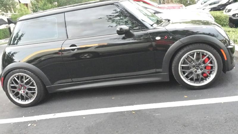

Sorry I've had no updates for the past couple of months, work, travel and other things had kept me from going forward. Finally I installed the brakes last week and been running the brakes with no problems at. They work flawelessly.
I went all the way with upgrading with the stoptech pistons ($250 extra) and powder coating them. In all, is it worth spending all the money on these brakes...absolutely not. But it was worth for me, because I like modifying cars. The car brakes excellent and there is no spongy feeling like some had mentioned. No need to upgrade my brake master cylinder or the brake booster either. Now if I ever want to do an"endo" on my car, it would be possible .
If you find a good deal on the 135i Brembos, go ahead and spend the money.
Keep in mind that you will need:
1. 135i Brembos
2. 135i Brake pads (any brand if you'd like)
3. Mini Cooper GP2 Rotors
4. At least 15mm spacers for the from wheels
5. Extended studs or lug bolts
6. Patience
7. Open up (shave off) the spindle brake mounting points 1mm on the top of the top hole and 1mm on the bottom of the bottom hole to be able to fit the brake caliper adapters.
8. Brake fluid (Dot4)
9. A friend with a mill so the can shave 3mm from the brake mounting adapters.
10. A friend that can help you bleed the car.
If you have any questions, please feel free to contact me through PM and I can guide you through the process.
Thanks!
