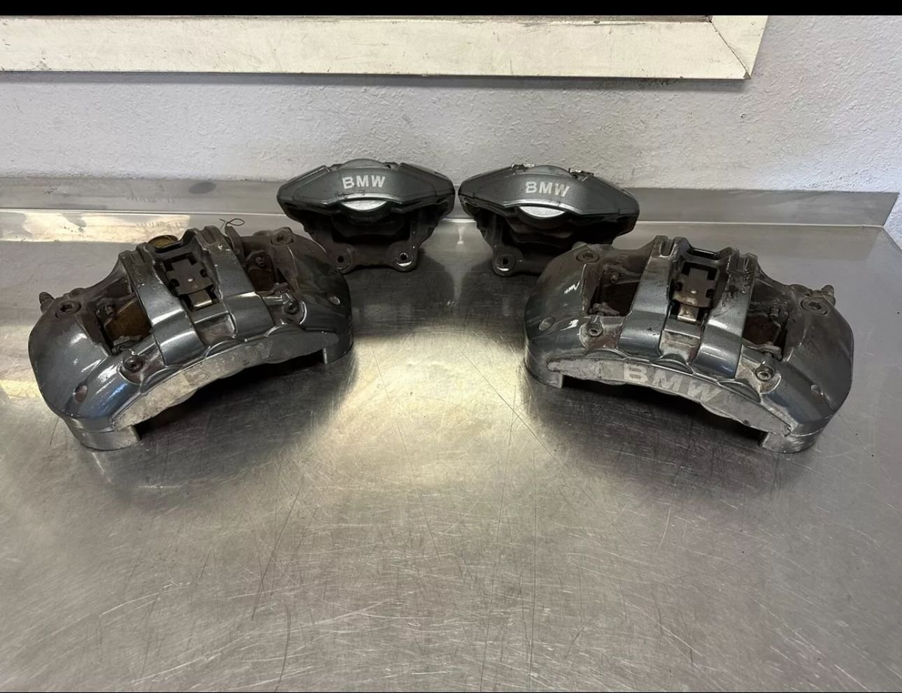

Anybody here ever tried or heard about somebody that retrofit a set of 135i’s on a r53? I know the front calipers are possible according to this forum but what about the rear ones? Thank you.

I don’t know anyone that has used the rear 135i rear calipers. If you used them, you would lose the parking brake.
