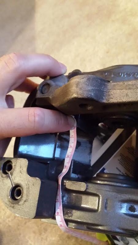

I would think that going over 26mm on the width of the rotors would be kinda risky. It can be done, but the measurements would have to change in order to center the rotor without it grinding on the caliper.
30mm would be the widest rotor size you can use.....and not really you will have clearance issues.

On the rotors size:
What I was thinking is that once the caliper is set in place:
If the rotor is bigger and has a different offset (depending on the brand), would it create friction?
I remember doing this on my old 350z, I adapted some wilwood brakes and created the bracket myself...but from wilwood I had all the drawings and measurments needed.
On the other hand, I'm still waiting on Brembo to respond to my inquiry.
Keep posting guys, thoughts, ideas and anyhthing you may want to add.
BTW, I also talked to Todd at TCE Brakes in AZ and he said that he could develop the brackets as long as he has a rotor, the caliper and the pads on his hand. He will charge a $200 engineering fee and obviosly the material cost. He can also machine a couple of them. Just an idea.
But I doubt we would have to reingineer far away from the 135i caliper adapter, its just a matter of repositioning the holes for the bolts to adapt to the mini.

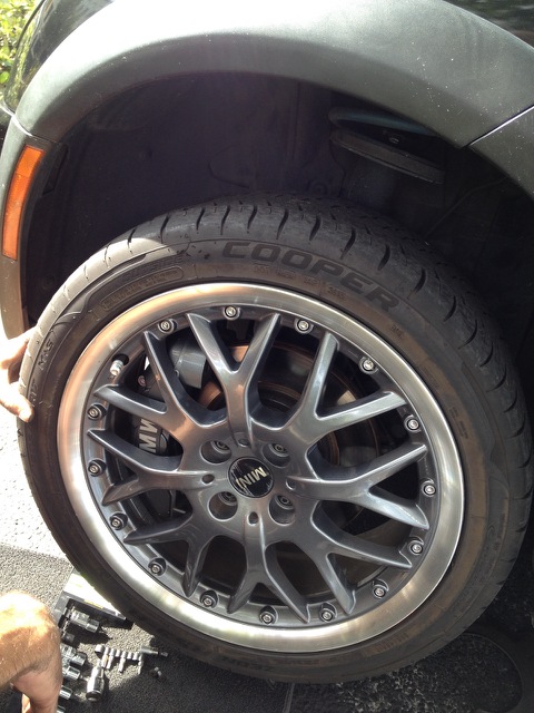

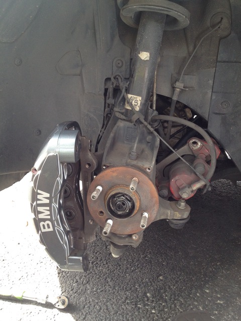

Hey guys,
Fitted the brakes. Coop3r helped me out today. Have a looksie.
Fisrt things first, they fit with NO need to buy an adapter. There holes to fit the caliper to the car are just about 1-2 mm off....nothing that just creating wiggle room on those holes wont solve.
There you go guys. I just have to buy the shields, 15mm sapcers, rotors, brake lines, and pads and I think we're good to go.
Once I get everything together I will post pics for you guys enjoy! And any problems I run to.
