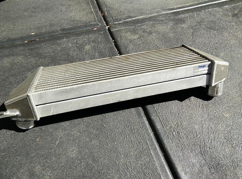

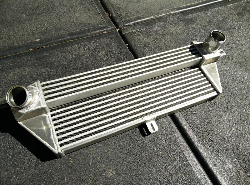

Hi NAM,
I'm just about to purchase a second hand Forge Intercooler, it's been on the vehicle for approx. 10,000km.
Are there anything in particular I should be looking out for? Also grabbing the NM charge/discharge pipes of him too... Photos of the actual parts are in attachment.
Any advice will help me greatly, thank you in advance!

Look for holes, bent fins, and make sure to pressure test it. If it all passes, you're good.

Took the intercooler into the local radiator shop yesterday and gave it a good flush since it had a fair amount of the oil residue, while doing that they found a couple of leaks around the welds, nothing major but that's all repaired now and it only took $25 out of my pocket.
Now I've dropped the intercooler off at another workshop to give it a thermal dispersant coating (TLTD). Not sure if it will do much on the cooling effectiveness, but the finishing color will be a semi-gloss black, so I guess its a two birds one stone thing?
