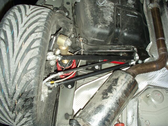

The trailing arm is the black curved object between the tire and the gas tank in this pic. It is anchored in the front to a pivot on the body, and at the rear is connected to the wheel hub.
