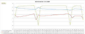

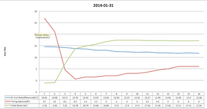

I took a quick data log before and after the DV+ was installed. You can see that there really isn't much difference in boost, but with the stock DV there *was* a very slight drop in boost at high RPMs. With the DV+ the boost stays there all the way to the upshift.
And this is with the DV+
Quick thoughts:
  • Boost never drops at high rpm
  • Boost comes back almost immediately after shifting
  • When on boost if you let off the throttle either partially or fully, then get back on it, the power is immediately there.
  • The quality is top notch. My original diaphragm wasn't torn but you could tell that it wouldn't have taken much for it to eventually fail. The DV+ parts will probably never fail.
  • Most importantly, there were no soft ECU codes thrown and everything was as quiet as stock, maybe quieter
I think that if your stock DV is fine, and you're not tuned for more boost, this probably isn't the best use of your money (and you probably wouldn't be in this sub either). But if you know your stock DV is leaking and/or you're boosting more than stock, this seems like a pretty good product. Hope this was helpful.

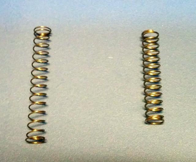

Do you use the factory spring or do they provide a modified or upgraded spring?

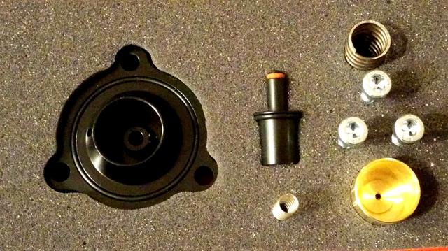

It came with two springs, one that replaces the stock spring (it's actually the shorter one on the right) and a secondary one that's installed right behind the piston. The secondary one they say is optional as it *may* cause a fluttering noise (not compressor surge) at low RPM's on some cars. I installed it and am not hearing any kind of noise. If you opt not to install it the DV acts exactly like the stock one (so, you don't get the more responsive throttle response) but it's still an upgrade since it replaces the rubber diaphragm with a brass piston.

DV+ assembled.
