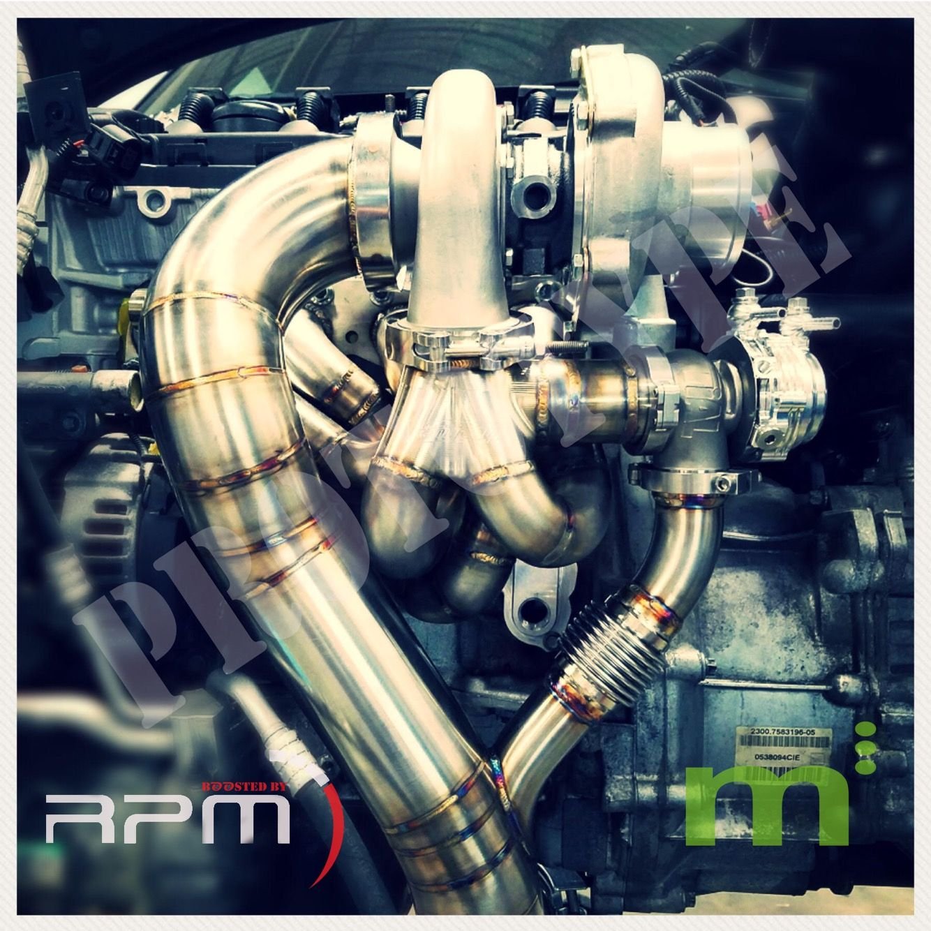

I’m running stage 3 RPM Power and soon stage 4 with my new turbo set up
Mario
mQubed Motorsport Manic & RPM Power Tuning
