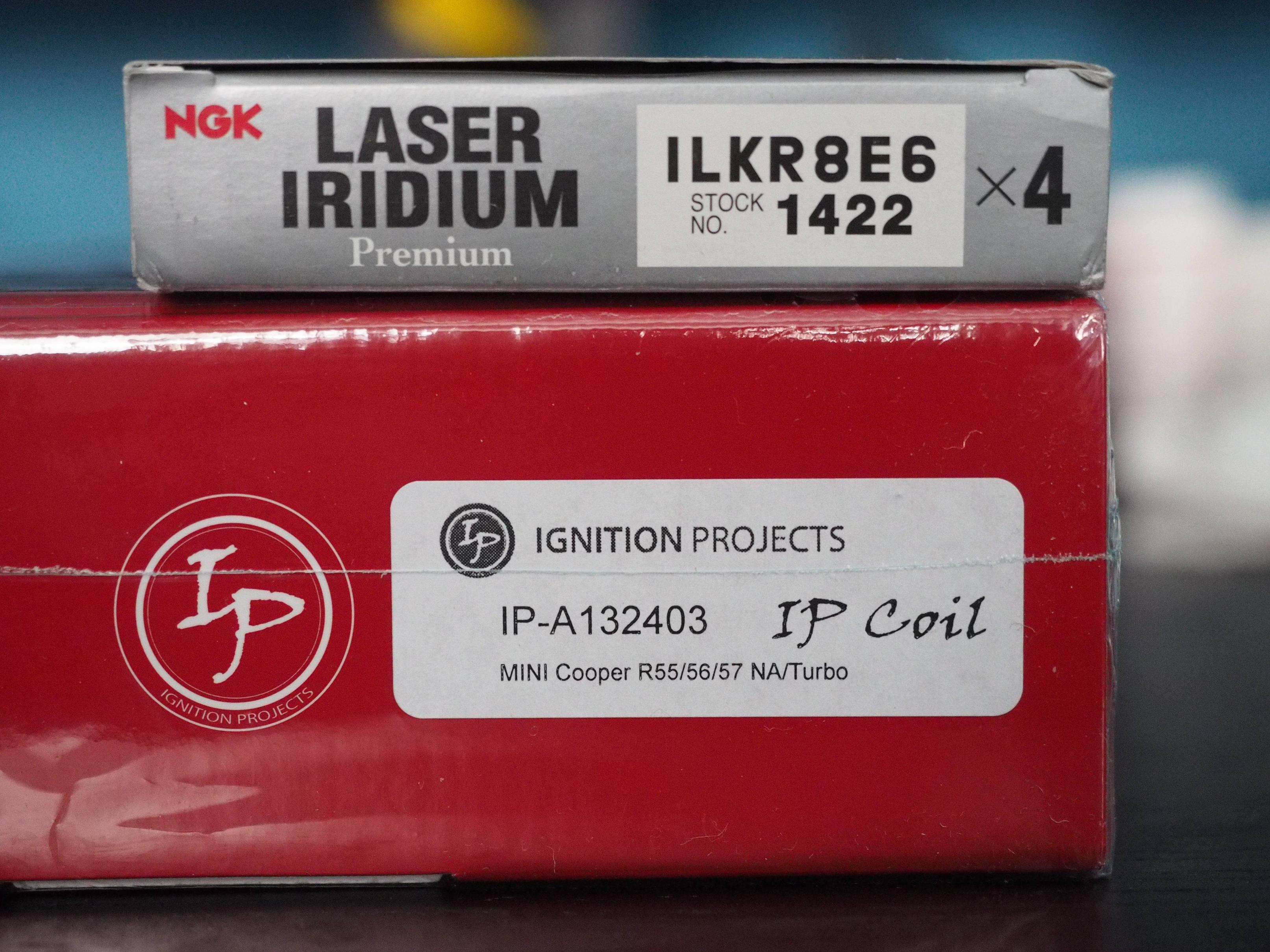

MCS 07 MANIC Stage 2b
Just got MANIC tune locally from kelvin@pws here in Vancouver.
I have R56 MCS 07 N14 , 105,000 km (65000 miles). Evolve catless DP, second cat deleted, Helix FMIC, GFB DV+, JCW Cone Airbox.
Prior to the MANIC tune, I had carbon cleaning done, oil changed and radiator fluid flushed.
I purchased the MANIC Stage 2b. The kelvin recommended me to get 1 heat range colder plugs. I also went ahead and got IP coils.
Manic Motorsport brings us N18 owners OBD II Tuning! Solution is finally here!-meujse2.jpg
I have 3 different tunes in the pass, starting from JCW Stage 1 to Alta AP and finally to MANIC. I put about
JCW Tuning Kit - 30000 km
Alta AP - 40000 km
Pros:
MANIC tune is very different from Alta AP. First thing you will notice is the coolant temp is lowered by 10 to 15 C when the car is at operating temperature.
The power delivery can only be described as SMOOTH. Compared to Alta AP, its a million times better. The idle bounce is gone. The random jittery under acceleration Alta AP map is gone. Compare to JCW Tuning kit, the differences is even bigger. Overall, the car feels move alive and torque delivery feel just right.
Cons: [Updated Aug 5 2016]
There is some tiny little pop and bang going from 1 to 2, a little bit from 2 to 3. After that, there is no more pop and bangs. I am kinda disappointed that MCS 07 does not have any pops at all. I'm talking to the manic and see what they can do about it. Every other models have pops and except for 07.
As for the Ignition Project Coils, the difference is marginal. I ran Stage 2b for 250 km on stock coils and compared it with Ignition Project Coils. It honestly feels very little difference. It's hard to give a honest answer since there is so many new parts installed. I did have coils, plugs, carbon cleaning and tuned all at the same time. I did notice that on stock coil near the rev limit, it does not pull as hard when compare to the IP coils.
If you are in the Canada / Vancouver area, contact kelvin@pws for MANIC tunes. Highly recommended!
