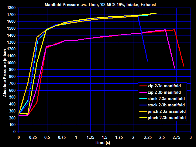

I need some testing ideas from those who claim the device has an effect. What rpm would you suggest for doing this testing? I had been letting revs drop in 2nd gear with my foot completely off the gas. When the tach indicates 2k, I floored it as fast as I could and held the pedal down. I did the same thing at 4k. Would this be a good test of the device?
What I plan to do is log upstream and downstream pressure for these tests, using both the stock hose and the device. I'll do several runs from each, and randomly number them on the chart. Then, all of you can guess which runs had the device and which didn't.

Correct me if I am mistaken, but isn't this device intended simply to make the bypass valve work more quickly? It doesn't seem to be touted to fix yo-yo, stumble, etc.
Yeah, that's what they're saying, but if it damps the action of the bypass valve the only place that you're going to see any difference would be in transitions. Frankly if it smoothed out the throttle response (cleaned up some FI sloppiness) it'd be worth trying for me.
Am I off-base in my thinkng as far as testing goes? Based upon your previous graph above I'd assume that you'd only see something in the first .75 seconds.
I'm getting the ECU upgrade at the dealer as we speak. It'll be interesting to see if the whole point is moot. (9/02 build.)
Jeff
Andy you are 100 % correct. All we wanted to do was make the supercharger do was come on a bit quicker. Ther was some talk about it possibly helping the yo yo etc. but this was not from our camp. Once that issue was raised we did one limited test on a car with severe yo yo with no positive results. One area for you to look into is at what RPM the valve closes between cars with and without the device. From the cars we have done personally maby 40 to 50 at this stage there is a noticable difference to the eye. Would be good to get a accurate number on that if possible. Good luck
A quick note here , We have found the divice already has the valve shut completely by 2k RPM. You might need to go lower on the RPM if possible to start the test. I think If you can perhaps measure from 1000 Rpm without the divice go full throttle then do the same with the device you may see something there . Just a idea , have fun.
Randy

When you say the valve closes more easily and quickly, do you mean under load? If the valve closes earlier while just revving in neutral, what effect would that have on driveability?
You claim that this causes boost to come on sooner, but if as you say, the valve is already closed by 2k rpm, then what effect can this device have while driving? I'd be happy to document any test you can suggest that shows a difference in boost response, but it wouldn't make any difference if it doesn't happen during the range of real-world driving (2k-7k rpm).
