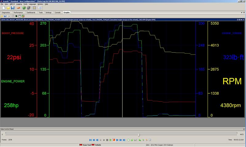

Played with this briefly before my car went in for a new clutch/DMF. It would be interesting to see relative comparisons of other people's cars with different mods since so many people have the app and capability to log real data.
I used Dash Command to log the data and the free version of ScanXL to read the file. Entered as many of my car's parameters as were available.
I used alt/prt screen to dump the file into MS paint and reduced it to 75%.
Open to the format but if everyone standardized to the same parameters it would be easier to read and compare.

Cool idea. My only comment is that HP and torque might not be the most useful quantities, since they are estimated using many other inputs (and looking at your output, considerably over-estimated unless you are very highly modified and tuned).
I get similar over-estimates of power, which I don't totally understand. It seems like if you can provide an accurate weight you should be able to derive HP pretty easily. Maybe I'll try to do that using basic parameters and compare it to the DC over-estimates.
Edited to add: I see that those might not be gross over-estimates in your case.

Hehe. Maybe not but what interests me is the relative differences since a lot of people would be using the same tool.
I'll log a better data set once I get my car back. Before tune, after tune, and then after the DP and new tune.
Yes definitely. We would also have to agree on a test method too. Ex: flat land, 3rd gear, 3000 rpm to red line, 5 runs take the average. Regardless of the validity of the hp and torque calculations of the app any assistance would be appreciated in picking the best numbers for...
  • brake specific fuel consumption (most confusing because it is not really a constant)
  • Drag coefficients
  • Frontal area
The brake specific fuel consumption setting adjusts the hp and torque calculation up and down. Per this post, "Our horsepower calculation relies on the BSFC setting and the calculated fuel flow (which uses MAF, or MAP and VE is MAF isn't available). Increasing the BSFC setting will lower the calculated HP". If nothing is entered it defaults to 0.44 (I get crazy high numbers. ex: 248 hp and 282 ft-lbs). Palmer recommends 0.50 to 0.60 for turbo charged cars (I have been using 0.50 and the numbers seem plausible. ex: 202 hp and 208 ft-lbs). Only found one article listing the minimum BSFC as, "348g/kWh at 2000rpm/2bar BMEP". I think this converts to 0.57 lb/hph. This page gives general BSFC numbers for different types of engines.
