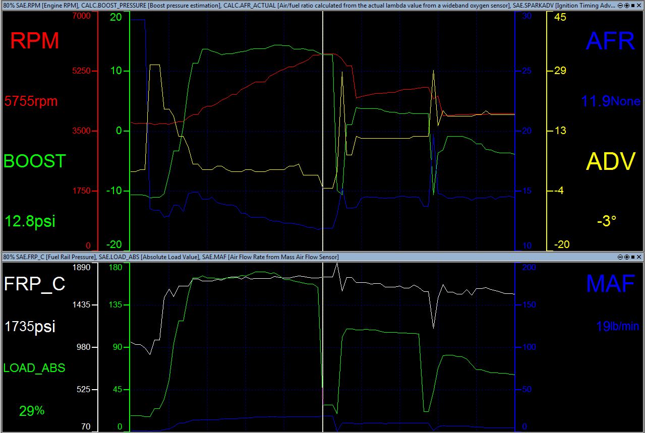

Hey SL,
Be glad to give you a hand. E-mail me your .lgf files and I'll take a look. Before you do I'd only ask that you make a few changes to your logging procedures that might help. I'd get rid of outside air temp. For logging purposes it's only useful for evaluating FMIC efficiency. Same goes for EGT, it's really only necessary when evaluating a new tune to ensure you don't overtemp the valves. After that's done as long as AFR is good then EGT should be within limits. Than I'd suggest adding FRP and Absolute Load. Load will give you an idea of what the ECU is asking for and monitoring FRP is always a good idea when evaluation AFR issues. I normally only log 7 or 8 PIDS at once to help keep the capture rate high. I've noted that with the iPhone 6 I can change the interval to 200ms or less and get a pretty decent capture rate about the same as ScanXL Pro. I think I need a new cable for my ScanXL as I'm not getting MAF on it at all.
PM me with you email address so I can send the the log files from Saturday and later tonight, I lowered my OBD-II Response Timeout from 500 ms to 100 ms. We'll see if that makes a difference or not. My graph doesn't show everything I was logging, I'm not sure how to add other PIDs to the custom graph made by cerenkov that he kindly gave to me, I'll ask him how to add Absolute Load and FRP to the graph.
If you were to use the default graph I'm sure you would see the data your looking (not Absolute Load which I added) for that's not shown in my custom graph. I currently have the following PIDs selected, let me know if I need to get rid of some please, that's 9 PIDs. Could my AFR issue be with the fact that I have lambda wideband O2 sensor and Command air/fuel ratio PIDs monitoring at the same time? I leave for work at 5pm PST so I will do some logging on the way to work and now while it's still 85F.
Persistent PIDs turned off do to monitoring of other useless trip mileage monitoring, it was recommended it be turned off for those reasons and it will increase capture rate further.
SAE.MAF
CALC.BOOST_PRESSURE
SAE.FRP_C
CALC.AFR_ACTUAL
CALC.AFR_COMMANDED
SAE.LOAD_ABS added per your request, many others removed.
SAE.TP
SAE.SPARKADV
Air/Fuel ratio calculated from the actual lambda value from a wideband O2 sensor :1

Two other things I noted were that the load calculated by the ECU was below normal, never exceeding 174%. I would expect ~200% at WOT in third gear. In addition the MAF readings were lower than expected.
Load is usually calculated based on RPM, mass airflow, throttle position and a constant scalar. Your maximum MAF readings were at 14 lbs/min instead of the ~19 lbs expected. In other words the ECU is only seeing enough air going into the engine to make 140 HP at the crank. I'd look for an air leak between the MAF sensor and turbo inlet and I'd probably also clean the MAF sensor while I was at it.

Keep Alive may not even be applicable to Bluetooth as I'm not very familiar with it. In a wifi connection the TCP/IP protocol is used. The keep alive value determine how long an idle condition can occur without requesting a new TCP/IP socket. The response timeout determines how long Dashcommand will wait for a response before sending another query.
I did see 4° of timing pulled once and the AFR's looked a bit leaner than a stock S tune. The factory file is pretty lean already but since it uses very little timing advance it can normally get away with it.
I'll buy some MAF cleaner and clean the MAF sensor, check for secure connections between the MAF and the turbo inlet pipe and try logging again this weekend to see if things change for the better. Did you notice all your findings (leaner than stock S tune, low MAF readings, 4 degrees timing pulled etc.) on all 4 log files?
I'm relieved you found something wrong, because finding nothing wrong has been the norm since I purchased the 07 MCS 2 years ago. I always knew something was quite right! Third gear has always been kind of weak when it comes to pulling hard to get the car moving, first, second, four, fifth and sixth gears have always pulled hard and fast.

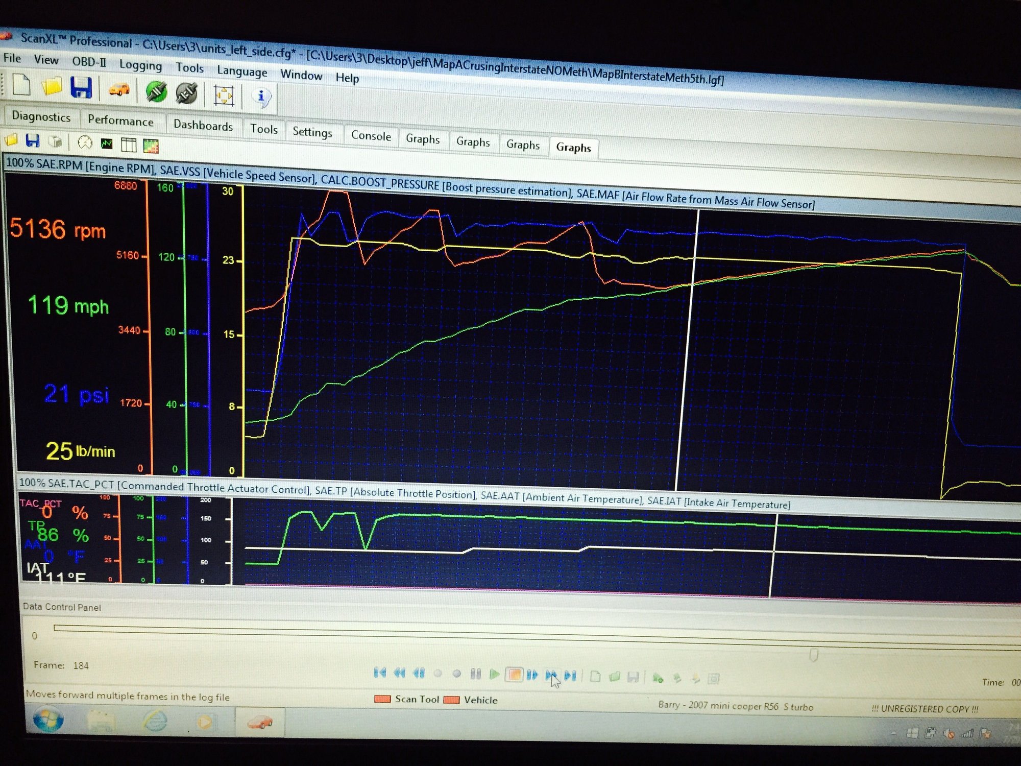

Tigger, do you have any idea on the typical MAF for manic stage 2+? Mine quickly flat lines at 23.4 on both map a and b and at various boost levels on both the stock turbo and now the JCW turbo.
I'm beginning to suspect that I'm actually maxing out the sensor. I've never seen it read higher.
Here are two logs, same day about 5 minutes apart, same gear (3rd) and you can see when I shift into 4th.
Per the Bosch spec sheet our MAF sensors are rated at 640 kg/h which equates to 23.5 lbs/min. However I have seen many MAF sensors read in the 24 to 25 lbs/min range. It's the luck of the draw as it were. I've attached Logs to illustrate.

Here is a 25+ reading off spritcar's Owens log

I cleaned my MAF sensor, the two metal plates were black before cleaning MAF sensor. Afterwords the metal plates in the opening of the MAF sensor were clearly visible.
I also want to ask you if it's preferred when I log this weekend if I should maintain 5500-6000 RPMs for a longer period of time than just a short, brief second so perhaps my sensor data can catch up and I can get more accurate readings from all my sensors when viewed on the graphs?
Reason I ask is because today I reached 19 lb/min except for the fact that it was recorded after my absolute load percentage dropped to 29% do to the fact I was forced to let off the throttle. This picture of a single frame from my graph isn't worth a thousand words, just showing I reached 19 lb/min.

Originally Posted by Tigger2011
Hey SL,
I reviewed the non-sport logs but can't find the e-mail with the sport logs. If you can resend those that would be great. My apologies as last week was nuts for me. Finally got some free time and took a look at the logs. The non-sport logs look good. If you look at the one from 12:27 and the one from 12:36 you'll see AFR's in the low 11's upper 10's with 5 degrees timing and 20 lbs/min. Didn't see any pulled timing. When you hit the rev limiter your MAF and load will flat-line as the ECU pulls back.
BTW are you running a catch can yet? If not I strongly recommend one. Every Mini I've ever pulled the boost side PCV line on had oil in it. When oil mist gets pulled into the intake charge it kills your effective octane and will cause knock. A good catch can is cheap insurance. Dealer shouldn't give you a hard time over it either unless they're a committed misanthrope.
No OCC, but that might change soon! I'm probably sucking in more oil mist in 3rd gear than any other gear because it never happens in other gears, the oil mist must be all cleared out after a long harder pull that by the time I go into 4th gear, there's less oil mist to enter the engine, I'm just guessing here. I was starting to wonder why my MAF and Absolute Load readings dropped off a steep slope all of a sudden. I was surprised to see max boost hold on as long as it did with this smaller turbos 37mm compressor! Wait till you see my timing in Sport Mode!
Email sent.
