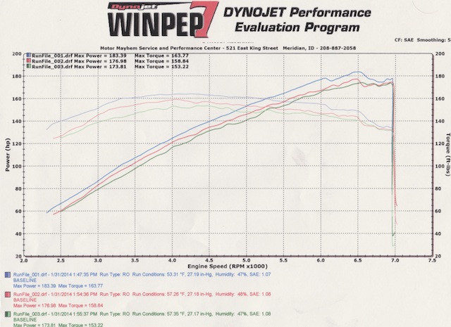

Im just going to repost this from the dyne thread.
Here is my dyno results for the baseline with no Tune yet. Pulled in third gear 2000-7000rpm
2005 R53 94,000mi
2600 ft above sea level
- WMW 15% pulley with proper belt
- Electric water pump
- 380cc JCW OEM injectors
- 1 ball exhaust
- Modified CAI
- 92 Octane with 10% alcohol
1st Pull - 53.31 F, 27.19 in-Hg, Humidity 47%, SAE: 1.07, 183hp and 163 ft-lbs
The first pull was the best of all three. I was able to do a total of three pulls.
I wasn't very happy with it because they did not have a fan to place over the IC and the fan they did use was to far away so I had some heat soak hitting pretty hard.
Next time I will arrange for a proper fan. But I still have mods to do so this is just the baseline.

preety solid numbers

Did they log AFR? I'm interested to see the AFR on untuned yet modified cars, with or without 380cc injectors. Anyhow, nice numbers ! A tune and header would get you to 200whp.

They didn't monitor it because that would have been considered a tune dyno and would have been a lot more money. Bummer though.
Ive got the OBX-R header waiting in my room and the exhaust in the garage ready to be installed. I just have to decide if I want to go with a more OEM piping approach (wrapping around the battery box) or the R56 (remove the battery box and straight through).
There are also some other mods, upgrades, and additions waiting to be added.

183whp on those mods is a solid number
Looking at your graphs, the heat-soaking is clearly visible. Did they allow you to cool the IC down in between runs with water?
Also, at 6100rpm, you can see the power dips down and drops off... with a proper tune, it's quite possible to get your car to near 200whp on your current mods.
It's surprising that the dyno shop won't log AFR That would give you a lot more valuable info to see if the car was leaning out at high rpm. Maybe consider finding a different dyno shop in the future?
When we do give customer dyno runs, we ALWAYS give them the AFR readings b/c that's the whole point of doing dyno pulls - to gather as much info as possible about the running condition of the car.
Just me...

I am hoping to pick up another 5-7hp with the addition of the OBX-R header and the new straight pipe exhaust (R56 style) and dynomax muffler.
I want to add an AFR gauge but haven't settled on a system. I want to go with the Vi-pec module for the R53. But now I am also considering the Sprintex for a few hundred more dollars.
We did a couple test runs before doing the based runs. They did not have the fan on which ticked me off. Then he added the fan after the first run because the second pull is where the numbers began to drop. His boss came out and said you need to have the fan on with these because of heat soak. He did not have a fan over the intercooler nor did he have water to help cool things off. I will be going back to the same machine and this time things will be done my way otherwise they won't be getting paid.
