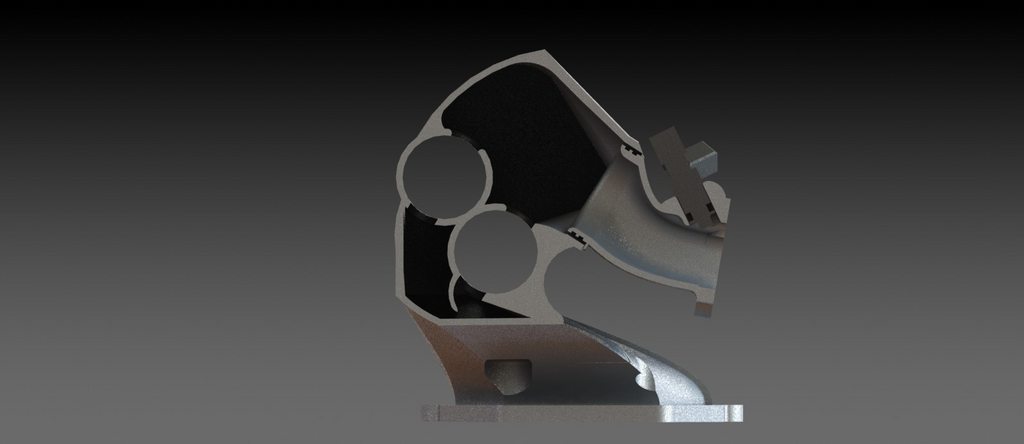

From: Inman, SC

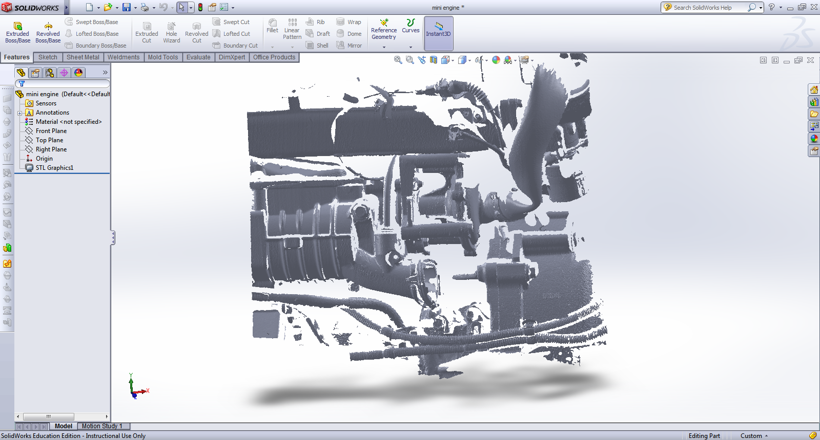

well the reason for the scans ^^ was to make sure I got ALL of the friggin angles and clearances correct for designing this.
Currently my computer (other one) is trying to crunch the numbers on the flow through this thing (without cores installed) at 5000 RPM in solidworks... may post that up later..
For now, this will just let me know who all it watching this thread still. haha!
still need to
  • add injector fittings
  • add o-ring grooves (this is actually two parts)
  • add BPV take off
  • add MAP sensor port
  • finish the mounting points for the water inlet outlet, and the back-side turn around (these cores will be in series and not parallel like the other cooler)

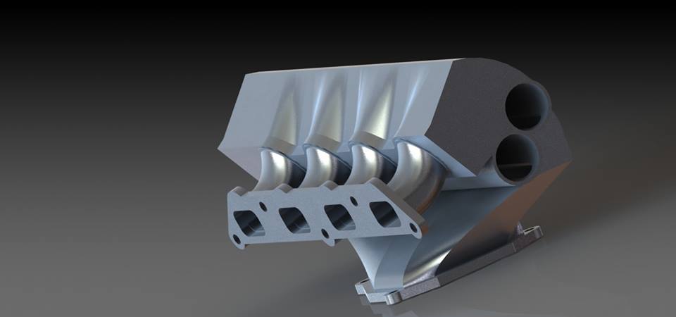

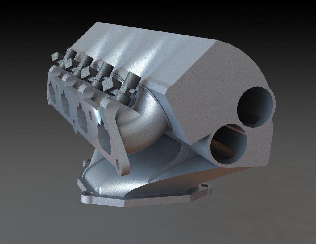

another teaser render for the day

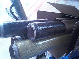

update: some good and bad.
Bad: investment casting is NOT happening. I actually started laughing when I saw the quote. I think it was just because the part was semi complex and for a one-off they did not want to deal with it so they priced it silly high. (we are talking $10,000 for 1 of these)
the good! I am making it a different way! and should remain on budget.
good #2 : I get to expand my working knowledge of composites even more! (I have done some work before, but never this complex and multi-part)
good # 3! : this is on order and should be here somepoint soon.
Still working on the models for the tooling molds, but they are coming along.

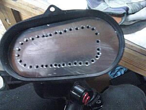

and another ADHD fueled and shitty phone pic update!
Decided to start working on the SC inlet tube as I was bored at home last evening.
Started working on the tube itself this evening, but no pictures of that.

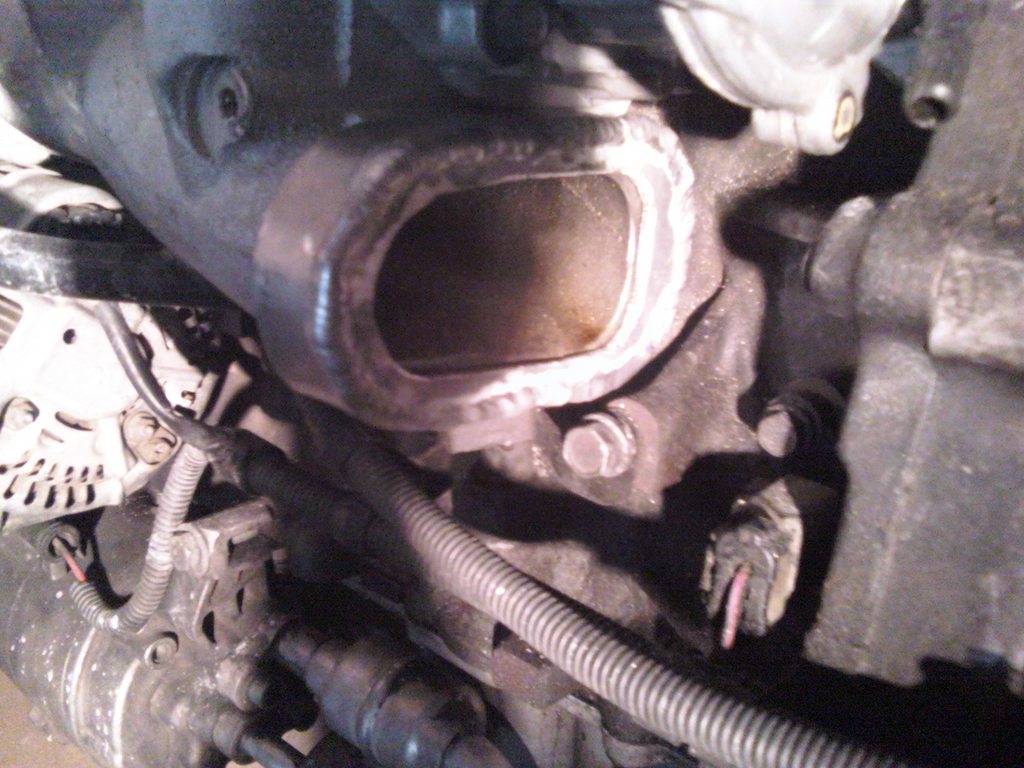

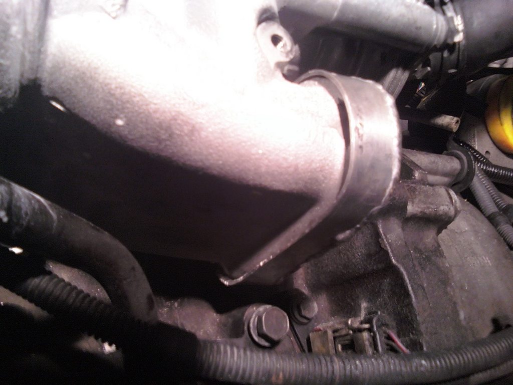

started by measuring the stock tube carefully, drawing it up in solidworks, printing, cutting out of paper, and laying the paper inside of the stock tube to make sure the profile was correct.
Once that was finished I transferred the stencil to some 1/8" aluminum sheet and cut out the outside path and drilled the "path" for the SC port (port-matched)
test fit is next

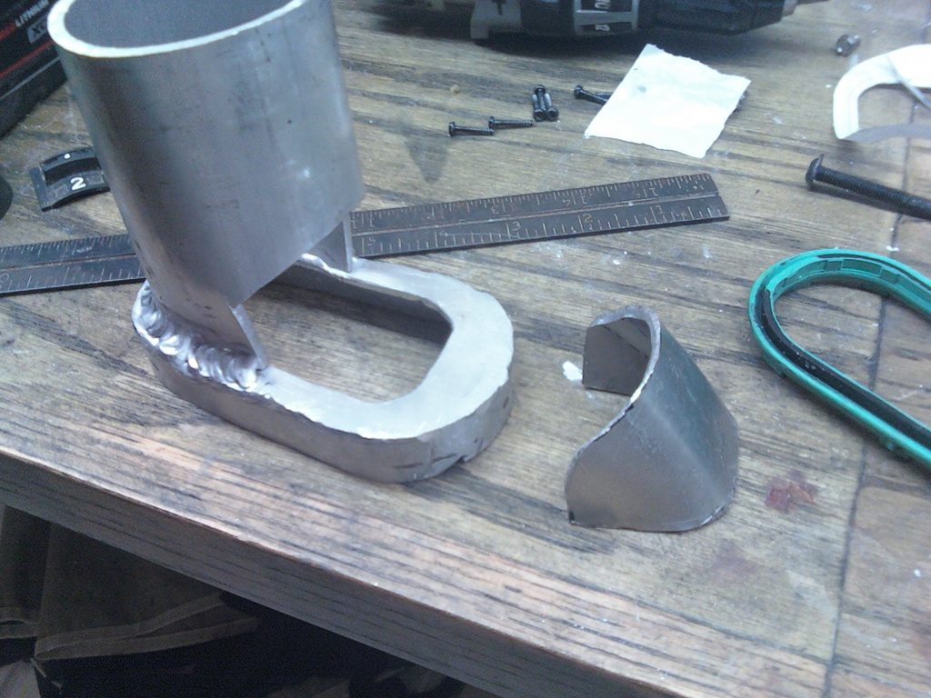

I then cut a strip of .080" thick ~.75" wide out of a sheet and used that to form and weld the "lip" that holds the gasket.
test fit again. EXTREEMLY snug. like a glove.
next up I used the rotozip (like a large dremmel tool) and a 1/8" end mill I picked up at travers tool and cut out the inside profile.
Finished it up with a rotary file in a drill and then followed with a finish profile handfile

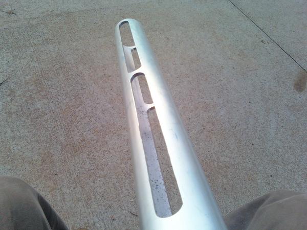

Ground the welds and filed the back side completely flat by hand, then took some 2.5" pipe, cut, crushed, pofiled, etc, to get it to loft from the 2.5" to the inlet oval (smooth transition) and clear pump fan, transmission, etc.

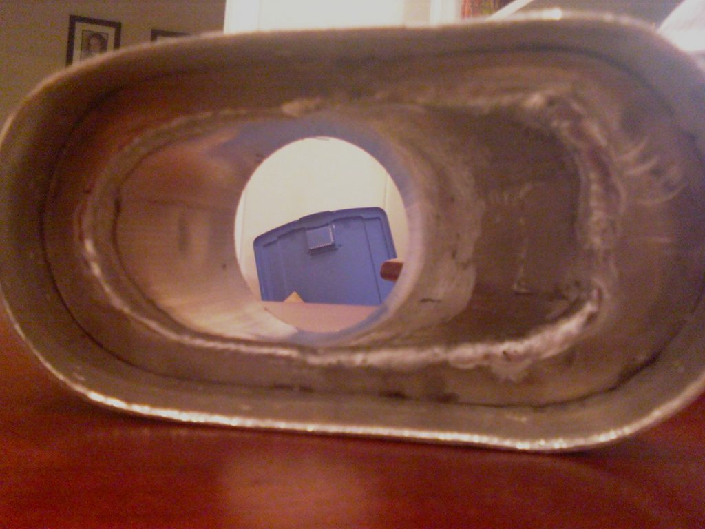

notched and crushed a pipe slightly, then took a soft blow hammer to it on a sand bag to form the pipe to the contour of the SC inlet and then cut out a piece of metal from sheet stock, clamped it in the vice, annealed it, and then formed it with the hammer in a vice.
Welded it all up and!!
before "notch" piece was welded in
and after!!
ground down the weld on the inside (welded in and out), but still need to polish it out more.
Enjoy!
Not the prettiest thing in the world, but I am actually a little surprised it came out this nicely! haha.
