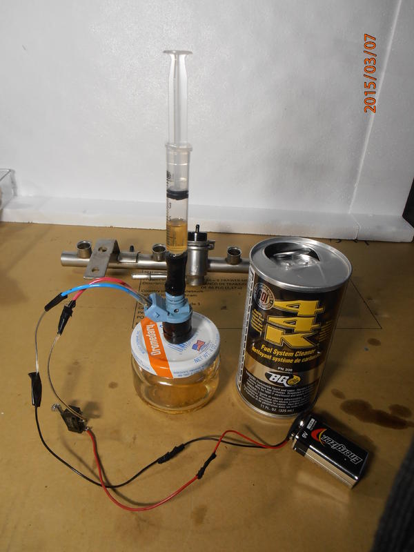

Fuel Injector Cleaner-Home Made photo & Schrader valve info
Here is a picture of a home made fuel injector cleaner which was assembled using ideas from several YouTube videos. Works great. Assembled from parts in the extra parts bin. Pressure in Syringe was more than enough for a nice spray. FYI, the injectors were not plugged, but decided to clean as part of this total build. p.s. Strongly recommend always replacing "O" rings unless they are near new. Also, am replacing the injector rail Schrader valve with part # 8080801047 GFLT which is an upgrade from OEM. It withstand greater than 10% ethanol. Would post on its own thread if I could figure out how to do it.
Attached Thumbnails Standard motor 380CC injectors-fuel-injector-cleaning-tool-002.jpg
That certainly is one way to do it, haha. I like it. Maybe try finding an actual 12v battery, and wire in a simple momentary (push & hold) switch inline. I'm not sure that a 9v battery is going to fully activate the coil and get you full injector pulse width.
Another idea is something like this:

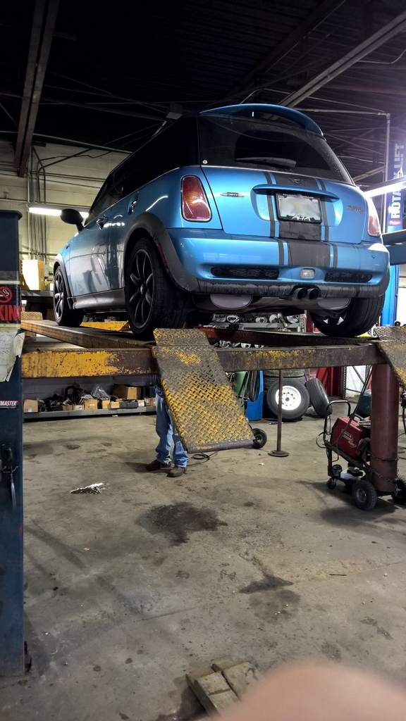

Well I finally had a chance to get my car into the muffler shop to get the bung welded in for the wideband O2 sensor for my AFR gauge I'm installing. I'm going to log the AFR numbers for the 200JCW tune with the stock 340cc injectors (I bet they are really lean), and then with the 380cc injectors. After that's done, I'm going to send my DME out to Way Motor Works to have it flashed with their Quick Tune set up for 380cc injectors....and then log the AFR's with that flash. hopefully I can get everything installed and figured out this weekend

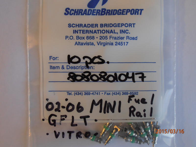

Attached Thumbnails Standard motor 380CC injectors-mini-fuel-injector-schrader-valve-rail-001.jpg   Standard motor 380CC injectors-mini-fuel-injector-seimins-380-340-bosch-550-2-.jpg

The Innovate Motorsports MTX-L AFR gauge I bought comes with a Bosch WB O2 sensor that has analog outputs that will take the place of the factory narrow band O2 sensor if you solder in a few resistors to "trick" the ECU to think that the NB sensor was still hooked up....BUT...the more I read about the people who were pulling the NB sensor and using the WB sensor to feed the gauge, and the ECU...they all seemed to have reliabilty issues. Most people were having issues with the resistors burning out....and I didn't want to deal with a dead O2 sensor when I was driving the car.
I'd much rather keep the factor NB sensor for the ECU, and use the new WB sensor to feed the gauge.....that way I don't loose any reliability. The last thing I (and anyone else) wants is to be driving their car and have their O2 sensor malfunction on them.
Plus...it only took 20min, and cost me $25 to have the new bung welded in

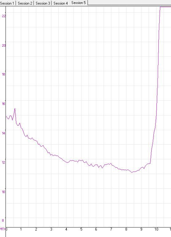

Well I finally got my AFR gauge installed tonight. I fired up the logging software it came with and made a 3rd gear run starting at 3000rpms running all the way up to 6500rpms. This is with the 340cc injectors, the JCW 200hp flash, jcw exhaust, jcw head, pipercross intake, and WMW 17% pulley making 16psi of boost at 6500rpms.
As you can see.......even with the 340cc injectors.....it was running on the rich side. I guess that just proves that all of the guys buying 440cc injectors for their CooperS's with just a pulley are wasting their money
I'm going to install my 380cc injectors tomorrow....and log another pass to see how it looks......I will post it as soon as I get it.
The left side of the chart is AFR's....the bottoms is time in seconds.

I'd like to see corresponding boost values, too, but I understand that's not going to happen.
Overall, the AFR numbers are fine. You're at 12 by 3500RPM, and between 11.5 and 11.8 or so until redline. At what RPM to you hit full boost? (did you notice?)
So, I actually wouldn't call those numbers "rich" at all. People tuning for a mix of power and safety are generally in that 11.5 AFR range. 11.7 - 12.0 or so is still fine and makes very good power, but lessens the margin for error. Having said that, for me, I prefer 11.5 or so, then taper down to 11.2 at full boost. The leaner you run, the higher EGT's get, and heat is our enemy. With those numbers, I've never had heat issues, detonation issues, or any catastrophic failures on over 6 tuned forced induction cars.
IQ, frankly, that chart looks decent. You might be able to take enrichment a bit earlier and richer overall, but just a hair. That depends on how early boost comes in. The real art to tuning is timing tuning, and that's something a good tuner could solve. I'd be interested to know IDC, too.

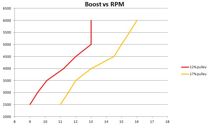

Also, here is a chart I made a few months ago when I swapped the JCW pulley out for the 17% WMW pulley. It shows where the boost comes in at (you has asked about it a few posts above).
In case you haven't noticed...I like charting things.
