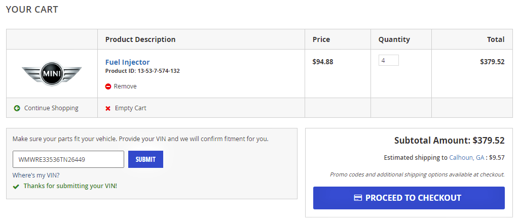

@Eddie Vergara
RE: new factory units
Just noticed recently that dealer price on the blue JCW injectors has came down a bit and even though I don't need them at the moment, I went ahead and bought a set to have in the stash for future use if ever needed.
MINI of Orland Park has the best price that I found and shipping cost is reasonable.
https://www.bmwpartsworldwide.com/

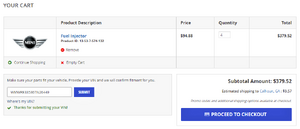

Originally Posted by MCS4FUN
OBS - Have you received those 380cc injectors and were they correct P/N? That's the lowest price I'm seeing online, incl from forum sponsors (2x $95/ea or higher). I'm still evaluating what might work best for mine but at that price, I'm tempted! Added 4 to cart but haven't yet reached for my credit card...
No, just ordered this morning.
Doubt that I will receive them before Sunday when I'll be going on-the-road for a 2 week job, so won't be able to report anything until after I get back home.
Pretty sure though that yes it is the correct part number.
MINI dealers in my experience have odd fluctuations in price, often just out-of-the-blue for unknown reasons, and adjustments in the secondary market take some time to recalibrate, for example right now ECS lists them at $216.76 and may remain at that quote until adjusted, if ever.
I'm continually checking in on dealer pricing and have a list of certain parts I regularly check on, for instance the insane cost for 17517565302 remains unworldly stratospheric but I still hold out slim hope that one day when I check it may be slashed in half similar to what happened with the JCW injectors.
Secondly, I'm ever increasingly paranoid about parts being discontinued so I'm trying to build up a stockpile to have on hand,
and whenever I see a factory part priced at fair bargain rate then I'll grab it for the stash.

Wow, not only are those JCW 380cc injectors 95 bucks each, but it's US stock. I was expecting shipping from Germany, but just got shipping notification.

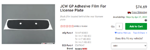

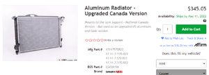

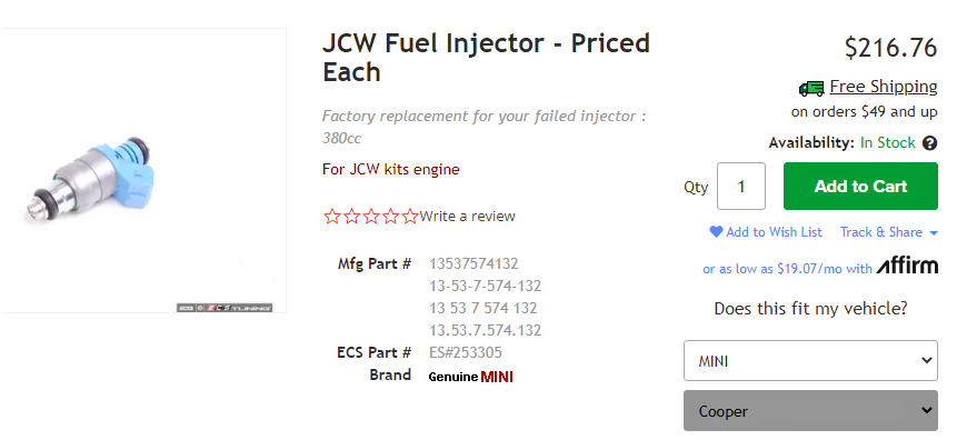

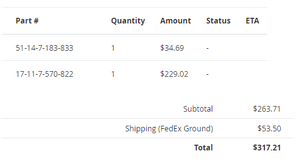

Much better price than the crazy number that they were previously selling for, but generally still a bit expensive, especially in contrast to the China ebay knockoffs which are cheap as chips, but I just can't bring myself to trust those even if initial flow rates are the same as the factory units because only time will tell and I'd be more willing to gamble if someone did the same flow rate test after having them in use for 16 years without failure as my original OE injectors are still rock-solid reliable after all these years and 150k miles.
BMWPARTSWORLDWIDE is now my go to place for OE parts.
I totally miss my old dealer though, MINI of Kennesaw who had easy online ordering for good low prices and it was great going to pick up in person.
Now my other 2 dealer options are 120-140 miles roundtrip and currently their online ordering is disabled so you have to ring them up on the phone, then get quoted prices on the higher side, so it's a big bummer because some of the larger parts are a bit pricey on shipping if ordered from an online dealer...
...like just this morning I ordered a new Canadian-spec radiator and delivery fee was $53.50 but their parts price beat my 2 local options by $75,
and beat ECS by an even bigger margin...
...threw in the GP license plate trim too because they had it at a good price and it added no cost to the shipping,
for a long time this part was like stupid money so I'm glad to see it more reasonable even if still pricey for a dumb piece of simple vinyl.
