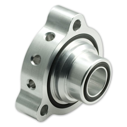

hmmm, Are we talking about the same thing? This is what I have...

That is not a diverter valve. It's a vent to atmosphere adapter for the OEM diverter valve.

oh, lol... It works/sounds good.

There was another member here who has that bypass valve spacer along with the ALTA spring and says that it works and sounds good. Anybody else have any opinions on that forge spacer? Is the fact that it indeed vents to atmosphere not a good thing? I was thinking about doing the spacer and the spring combo but don't if it's going to cause problems.

MAF meters incoming air for fueling. When that air just disappears from the system and the check sum between the maf and the map ... Its not good, but it does sound cool.
