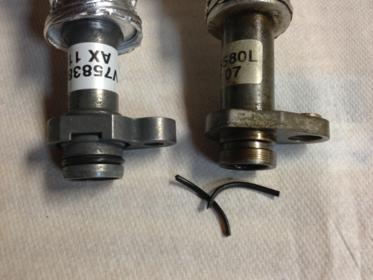

Just pulled out the turbo oil line. A lot easier than thought. I took me roughly a hour to pull the feed line out. Parts are coming tomorrow. Yay!
Look how loose the feed lines are. Notice the red mark I made. Both sides of the feed line are like this.
Attached Thumbnails Turbo oil line leak, Bad Day.-image-3924683307.jpg   Turbo oil line leak, Bad Day.-image-4246039080.jpg

Impressive. Took me 2 hours just to get to the point where I had the downpipe out. Goes to show how much more efficient someone is when they know what they are doing.
