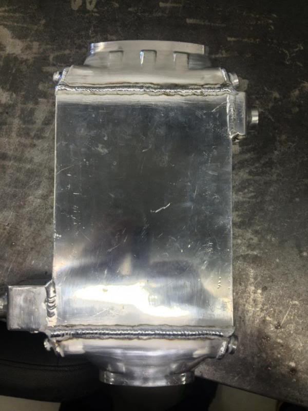

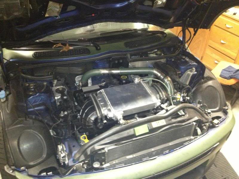

The water flows across the core in the opposite direction as the air. The water enters the core through a series of baffles where it makes a right hand turn, flows through a wafer thin jacket, and makes a left turn through another series of baffles to the exit. The idea is equal distribution of water through the core and full heat exchange. The hottest air hits the hottest water and coldest air hit the coldest water. The water travels in a Z pattern through the core.
So far the results are fantastic. Previous peak AIT was around 50-60*F above ambient temp and now I see a peak of 18*F with average between 8-15*F above ambient air temps. Much of this is heat soak from the aluminum intake manifold. I plan on installing a phenolic spacer on the manifold and wrapping both the manifold and intercooler in an Aerogel wrap I am working on. This will allow the intercooler to dedicate almost 100% to cooling charge air rather than the double duty the current Air/Air intercooler is doing cooling charge air and engine radiant heat load.
Here is a pic of the bottom. You can see all the bungs added to the end tanks for pressure and temperature data logging.

Here is a pic of it on the car. I had to make some changes for PCV and rebuild my chargepipe. You can see the clear bleeder line that I have running from the small integrated reservoir. This picture is actually clear enough to see the thin water and thicker air charge rows.
This intercooler does not have our bullnose header bars due to the thinner width of the water jacket. If all goes well we plan on using this design on many future offerings like the Abarth, and possibly offering it for the R53 (if there is enough intrests). At that point we will invest in the bullnose extrusions. However I would have to make some changes to the below intercooler to allow a direct bolton.
The goal is ambinet intake temps 80% of the time. I am spending a lot of time researching thermal loads and management in the cars we produce parts for.

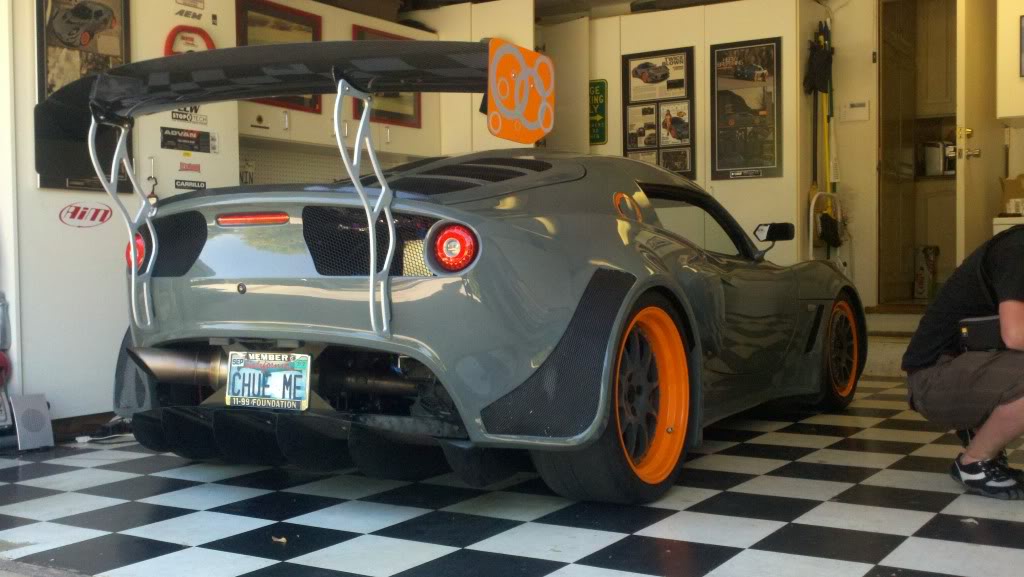

BTW I SOOOOO want an Exige S especially the new one. Have you seen the twincharged widebody Ronin Exige?
Watch this and tell me twincharging is not efficient!
https://www.youtube.com/watch?v=HmscSzFurwg

The horns I'm talking about are the one attached to the intercooler on both side. They are black and wondering if you had them coated with thermal dispersant.
Yes, I saw that exige on you tube. Its fast and looks like tons of mod money went to it. Twin charging? I don't have experienced with it or know someone personally so i can't say good or bad about it.
I was going to buy a R56 and now I just want an exige for a change of platform. My R53 is here to stay for a long time.

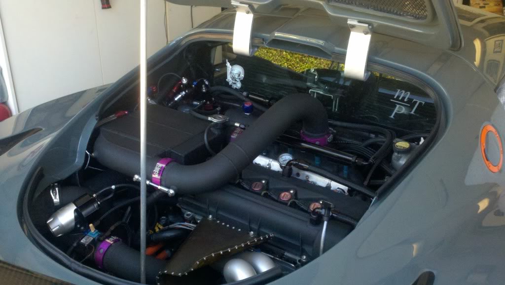

You mean this lotus?
Frank will tell you its biggest problem is heat management.
Just gotta get the temps under control.
