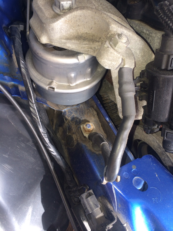

Is this a sign of a failed engine mount? Lol
2005 mcs, 6 speed.

Yup.

time for a new one.

Any cons of just leaving it alone? I either spend $200 on the way mount or $89 on an oem one?!

Watch what you use to clean the frame rail. The paint isn't clear coated and rubs off easily. Check your rag to make sure it isn't turning hyper blue when cleaning.

not a good idea leaving g it unaddressed. you have 3 options. stock, TSW, or VT. really depends what your needs are. each has pros and cons. stock is the cheapest but has highest chance of failure again but it is also quiet. on the other end of the spectrum is the VT which is the nicest but you pay for that. whatever you pick its better than leaving it alone

Thanks for the tip. Hydraulic fluid really does eat away at paint!
