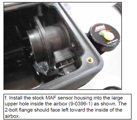

Nothing has to be modified. I went through the AEM install instructions again and that MAF sensor gets relocated into the airbox. The AEM pipe should work fine. See attached image.
Any other reasons why this shouldn't work?
