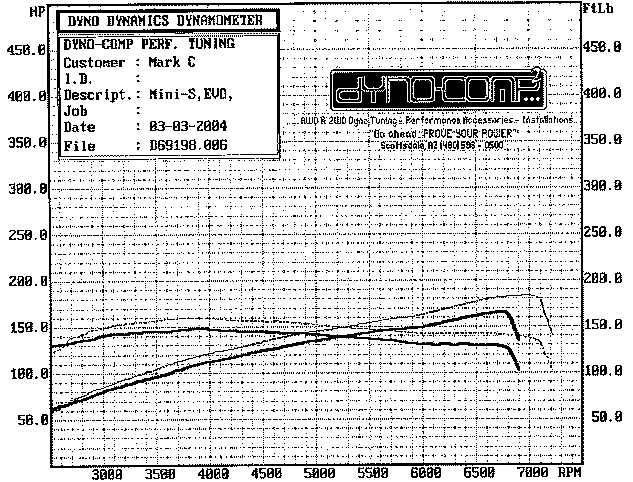

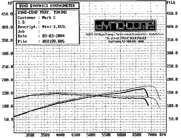

I see I have raised a few questions. First I would post if I knew how. Let me check my dyno sheet and get back with answers to above. Flash was Evotech. I was told very few Works have been flashed so I was a bit unsure of the results.
Again, I am not dodging folks and questions, very busy and need to get my sheet
Back soon
Back soon
I am a big fat lier.... my dyno is at 183-184 HP.
I have no idea how to post this... andy@rosstech, do you want me to fax to you so you can post??
I have the torque and HP sheets.
Sorry for puffing the figures, it wass not intended.
I can say, my total gain with TB and Flash is right at 14-15HP.
If your after is 183-184, then you only got 5-6HP with TB and EVO ECU.
<< to MarkC - Which ECU program did you use? How much torque did it add. I believe increasing rpm cut-off alone serves to increase horsepower without changing torque, so the actual torque increase is what would be impt. for me. What was 4500-7000 power increase? Thanks>>]
SteveS
first, I have faxed sheets to Andy to post.
with regard to torque, with the flash I saw a 10ftLb at 400 rpm... decreasing to 140 FtLb at 7000. Red line is now 7000.
Also, I do not know what the spped is limited to OEM or with WORKS but I can tell you I have been to 140 mph and felt like I had plenty to go.
Again, with Flash (Evotech) and TB... I am just at or slightly under 185 HP.
