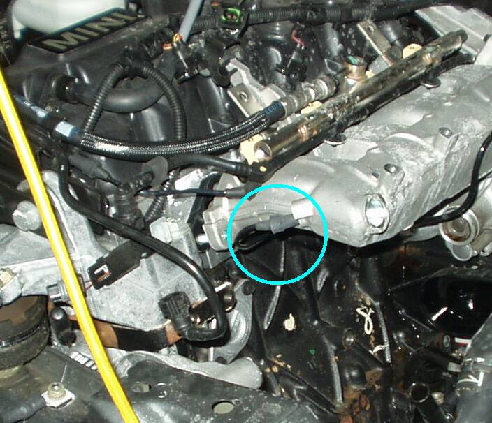

Hey Andy, where did you tap the boost guauge into? I can barely see the short tube coming out of the bypass valve. Seems too short to connect a T.
Thanks.

I pulled the rubber hose off this nipple and installed a tee and a short piece of vacuum hose:

That's where I added the T fitting as well. Some people tee off the other end, from the fuel pressure regulator. :smile:
