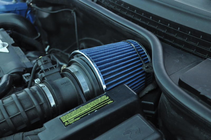

If you just want the blow off noise. I got a cheap mod for you then. A cone filter and some zip ties. I use a cone filter on mine and does a pretty good job. Cost me about 20 bucks for the cone filter from autozone and 1 buck for a couple of zip ties. I directly bolt the cone filter on the MAF sensor.

Its actually very simple. No cutting or anything. All you need I think is a flat head screwdriver and a tool to get the MAF sensor off the stock airbox. It takes about 20 minutes. Most of that time is trying to get the old airbox out. Get a cone filter that can fit the sensor (I think its 3 inches) and bolt it straight on and zip tie it down. The one on mine is a cheap Spectre p4 cone filter, I got at autozone for around $20.
