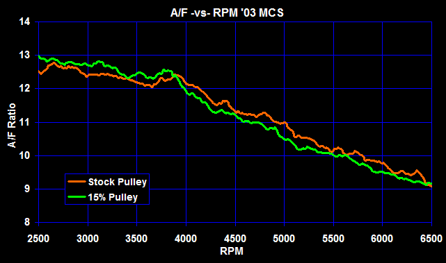

you might be running too lean. i would go do the v36 if you haven't
already.
Old Feb 19, 2004 | 05:59 AM
greatgro's Avatar
greatgro
Joined: Jun 2002
Posts: 3,359
From: New Jersey
you might be running too lean. i would go do the v36 if you haven't already.
Why would you say this? What evidence do you have on an MCS that this could happen? There have been a lot of A/F graphs posted on this site and all of them - even with the 15% pulley - showed they were running not just rich but pig rich! On the other hand, if you do have a graph of a 15% pullied MINI running lean please post it so we can learn from this. :smile:
Yes, I'd be very interested to know how you know it can run lean. When I had my 15% pulley done, the owner of the dyno shop told me that I'd run too lean with the 15% pulley alone. I told him, since he seemed so concerned about it, he could run my car on his dyno and show me. Do you think he took me up on my offer? NOPE!
