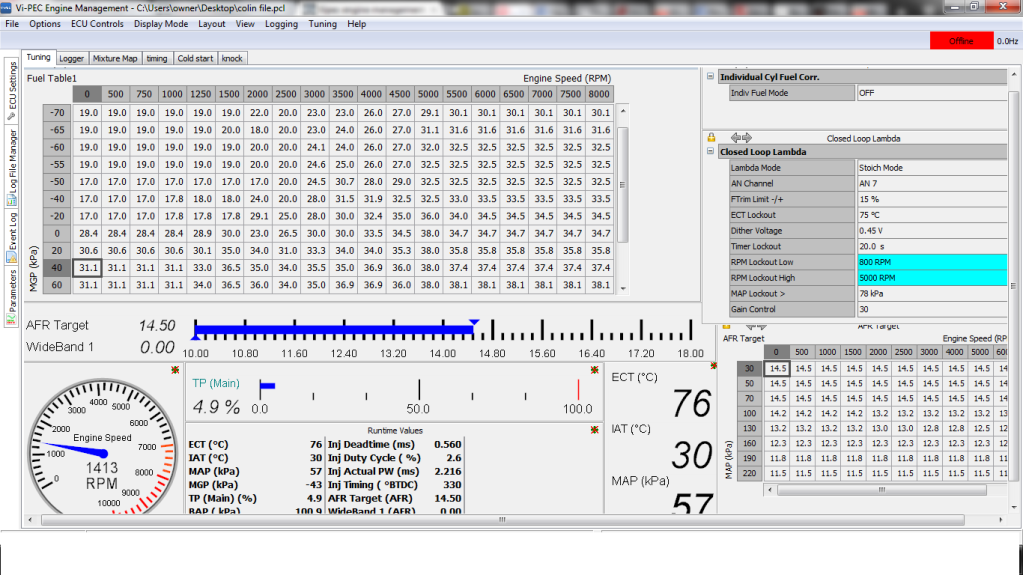

Here is the base "UNIVERSAL" standalone system, it's a good look into what the system is capible of.
VIPEC LINK
On paper it sounds almost too good to be true, but I am still questioning how it will react with the other MINI electronic's. The factory ECU is linked into the speed, and gear position sensors along with other data gathering device's on the car. Will it be able to run theese sensors so we can retain the basic items such as: the speedometer, the factory traction controll switch, will the gauges that come with the Chrono Pack still work, and all of the warning indicators (SES light, EML light, etc.) will they still retain any function? What about logging capabilities? I know Vipec has their own logging tools, but will they come at an extra cost?
VIPEC LINK

The tuning page's look is fully customizable. Here is a fuel table setup. This example has tabs setup for ignition, knock etc etc
