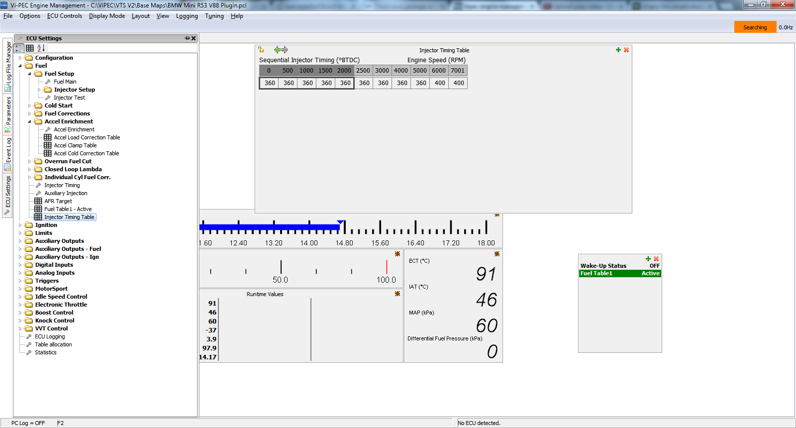

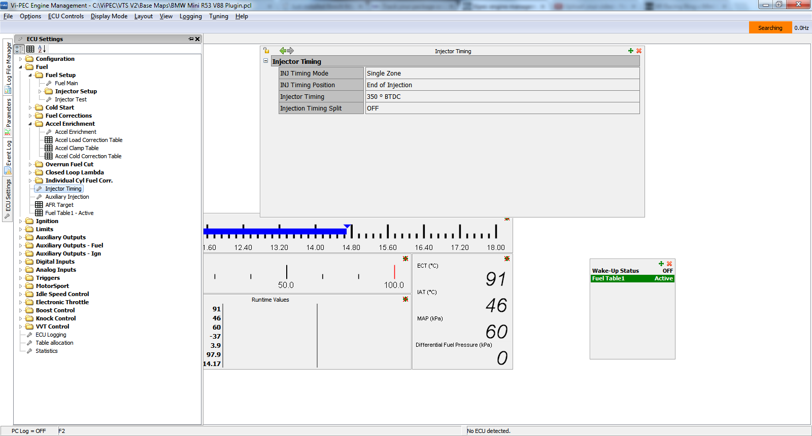

and stevescar60, yes you can adjust the injector timing!
You can set it up for single zone (same injector timing no matter the RPM)
or you can set it up on a table (change timing with changing rpm)
you can also specify if you want the value to be targeted as the injection pulse ends at that timing or begins at that timing value.
