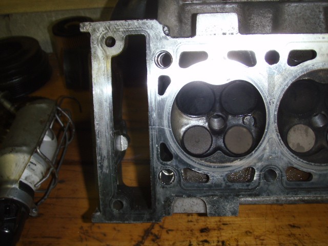

Hi
Unfortunatly the head is crack between the timming chain and the piston head
so need to order gaskets and find a head

Just change the head this morning and the problem is solve
Old Aug 13, 2011 | 08:01 PM
ScottRiqui's Avatar
ScottRiqui
Joined: Aug 2006
Posts: 7,201
From: Norfolk, VA
Glad it all worked out. It's strange that the crack was in one of the cylinders that had a good leakdown test reading, though. I was expecting something between cylinders 2 & 3 - either a crack in the head or a rupture in the gasket.
