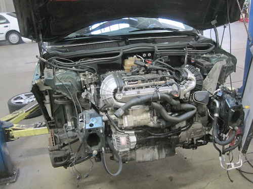

I am a Toyota tech. Just did my first cooper S clutch.
I read the guide by texas motor works plus talked to a friend who has done a fair amount of cooper work. My friend suggested taking out the motor/ trans as a unit with the S, then separating motor trans out of the car.
First impressions,
- Shift cables are hard to get off. I'll be buying the special tool.
- It's a big job so don't think of it as a clutch but more like an engine replacement.
- Bleeding the clutch hydraulics is difficult, I made a special tool after watching a youtube video.
-The frame extension tube bolts and motor mount bolts look the same but have different thread pitch. Don't ask me how I know that...
I enjoyed working on Cooper. I may be getting a Cooper soon. Nice drive experience.

I did the job without the special tools. I am also looking for a source for the tools. A google search has not turned up anything concrete.
You tube video on clutch bleed:
http://www.youtube.com/watch?v=68PIYbXk1nc
The engine will not crack its own oil pan but it will not balance without wood blocks underneath since the bottom is uneven. I will probably use a transmission floor jack for the next one since maneuvering the engine / trans with a regular floor jack is treacherous.
I used the Valeo clutch kit. It has a regular flywheel and new bolts in the kit.
http://cgi.ebay.com/ebaymotors/VALEO...#ht_2723wt_726
As for going relatively smoothly it was a bear. I put the friction plate on backwards and had to redo the job!!!!!!!
I can do a mini s clutch in about 10 hours now that I have done it twice.

The exhaust manifold gasket is metal and does not need to be replaced. You will need special mini cooper gear oil although it seemed like regular 90wt gear oil to me.
I wanted to use the cherry picker but there were not any lift points. One of the special tools is a bolt on lift point. Also you will definitely need the serpentine belt tool since the a/c compressor stays with the car when engine trans is removed.
The mini I repaired had a good rear main seal. Only replace the seal if it is leaking. A bit of residual oil around the seal is normal.
