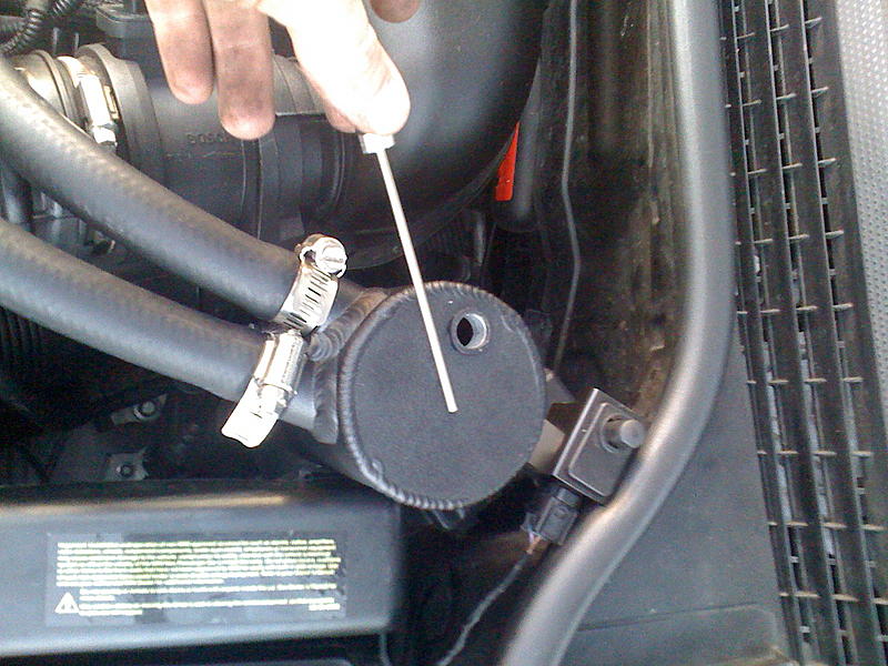

So last weekend I installed the BSH catch can (OCC) and so far after this week of heavy driving the can is still absolutely bone dry.
I know I should probably wait a bit longer but I took a flashlight to look inside and there wasn't even a spec of oil or sludge or residue of any kind, just a nice shiny oil catch can.
Maybe I installed it wrong or maybe i'm not waiting long enough, who knows? Hopefully someone here.
I've heard only great things on here and other forums about these catch cans but so far I feel like I just wasted close to $200 on extra tubing.
I should also note that when I had my HPFP and fuel rail replaced four thousand miles ago I was told that I had massive carbon deposits. So if you take MINI of Dallas' word for it then this thing should be catching at the very least something, right? Any suggestions here would be a huge help or at least ease my mind a bit that I didn't just throw a bunch of money out the window.
I've attached two photos, one of the setup (I know I haven't gotten the other hose clamp yet) and the other is the dip stick, and that is obviously without it being wiped beforehand.

Try connecting it up to the other side(the vent into the intake manifold) and you'll have some oil in that can in no time.

Why don't they include the direct dual boost tap? That is a good question and one that i do not know. To answer your question, technically you should be running two catch cans, one where you have it now and one where oxybluecoop was talking about(vent into the intake manifold). The direct dual boost tap blocks off the intake manifold side that it forces everything through the one catch can eliminating your need to run two catch cans.

All that location will catch is stuff from gunking up your intercooler WHILE under boost when the PCV system is running that direction.
Mine has also just caught a little there....But that little bit could coat an intercooler pretty well

Unless you need a ring job, the relative humidity of where you live is the biggest factor in phlegm accumulation in the can. When the motor cools down at night that humidity condenses in the motor and then gets blown into the can when you start up in the AM. The baffles then trap it there along with the nasty crud. Unless you've got a long commute the engine bay heat doesn't have time to boil it off. Around these parts, humidity is the least of our worries, LOL.
