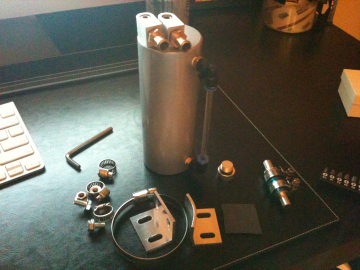

Sweet, this just arrived in the mail....
My impressions are: It looks to be made from quarter inch aluminum, it's actually pretty heavy and substantial to the touch. Came with a whole bunch of mounting harware but it looks like I'm going to have to get my own tubing.
Has a drain on the bottom w/ O-ring to empty it, however there are no baffles inside. Not too worried about because as tintman718 said, "the proof is in the pudding" lol. I'd highly recommend getting one if you don't mind saving a hundred bucks.
I'll install it tomorrow and follow up in a week to show what it catches.

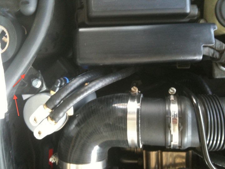

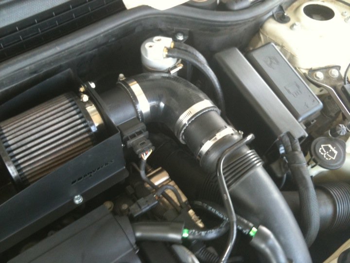

Ok, so it's all done and installed. Went pretty smooth, I ended up spending a total of $25 for the entire install, including hose and fittings I picked up @ Pep Boys. I "baffled" the inside of my can with a bit of steel wool and made sure to run an extra long length of hose on the input side to aid in catching the oil/water condensation.
As you can see in the last picture, I marked with arrows where I had to rotate the can a bit out of the way so that it wouldn't make any contact with my intake elbow while driving. Thanks again to tintman for the idea, I would HIGHLY recommend this as an alternative if you are money conscious.
