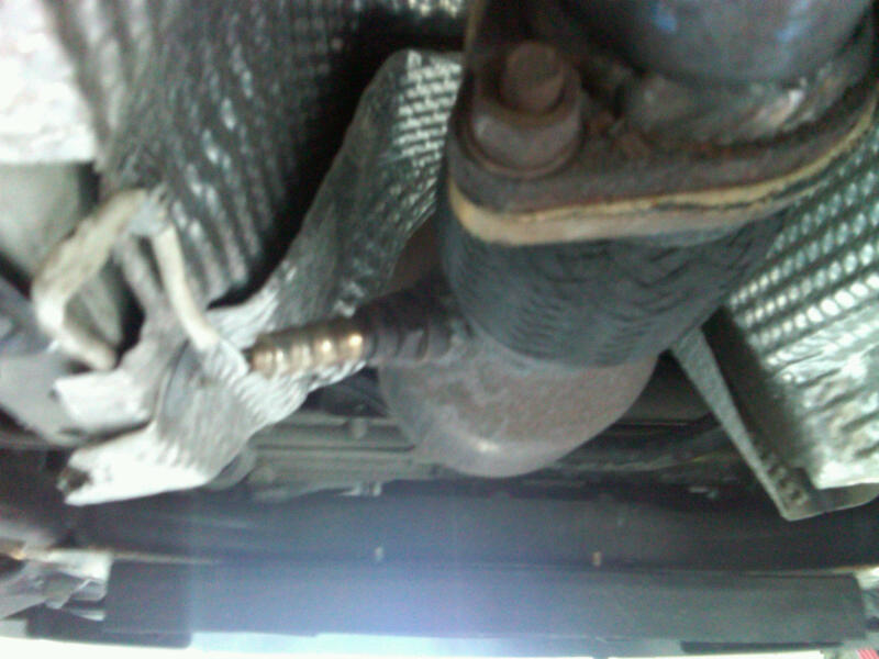

Here is a pic of the o2 sensor on the mynes header- could my problem be that the sensor is not at the 10-12 oclock position-??

Originally Posted by bebop86
Attachment 48240
Doesn't have to be at 12. Just not below 7 and 4 or else it pics up moisture.
Anyway, that's the post cat O2 so it should have nothing to do with AFRs. (I may be wrong of course).

stevecars60's Avatar
stevecars60
Joined: Mar 2006
Posts: 1,710
From: Northampton MA
^^ I believe you're 100% right. It has always been the pre cat for AF & EGT...
