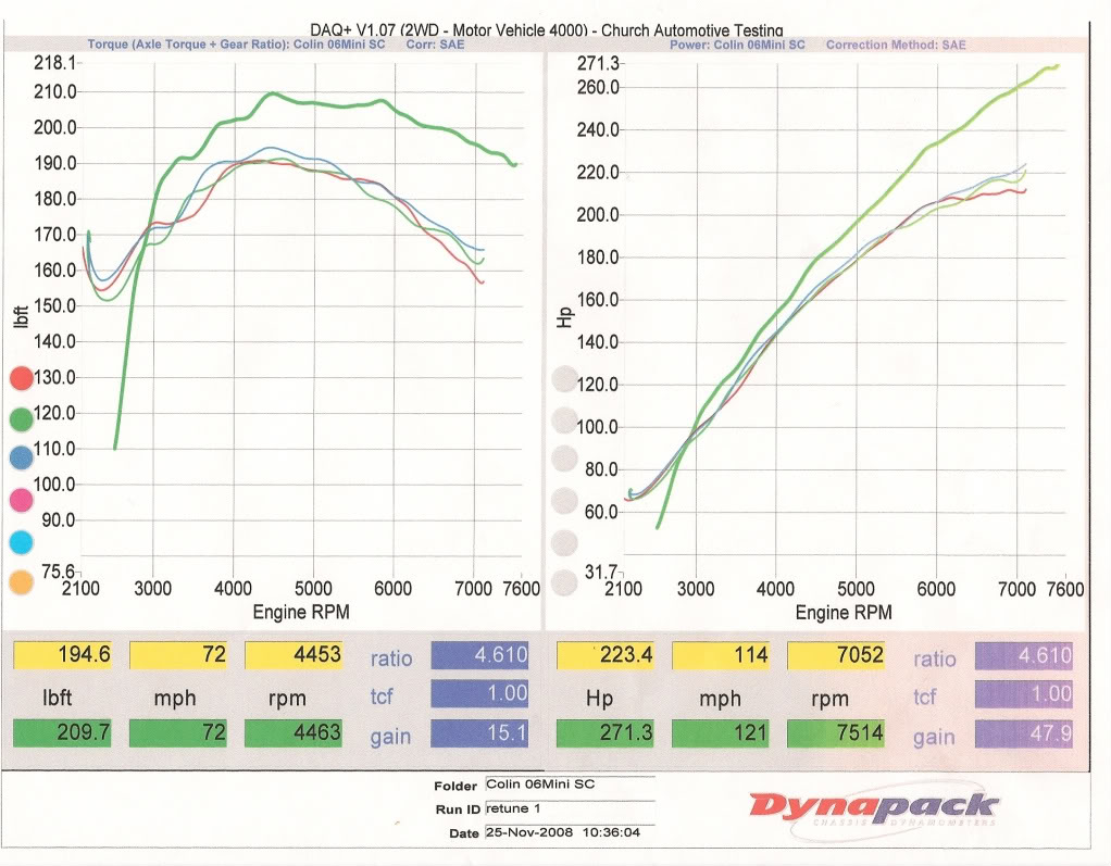

I like the Dynapack system, but I have not had a good following. I went to one near here, and my numbers were WAY off compared to other postings with similar setups using that system. I think the guys had no idea how to use it. They had the torque resistance set so high, my MCS sounded like it was choking just getting through the pull.
If you want something to compare to, get a couple of other friends that have MINIs and let them see how they do on the same dyno.
