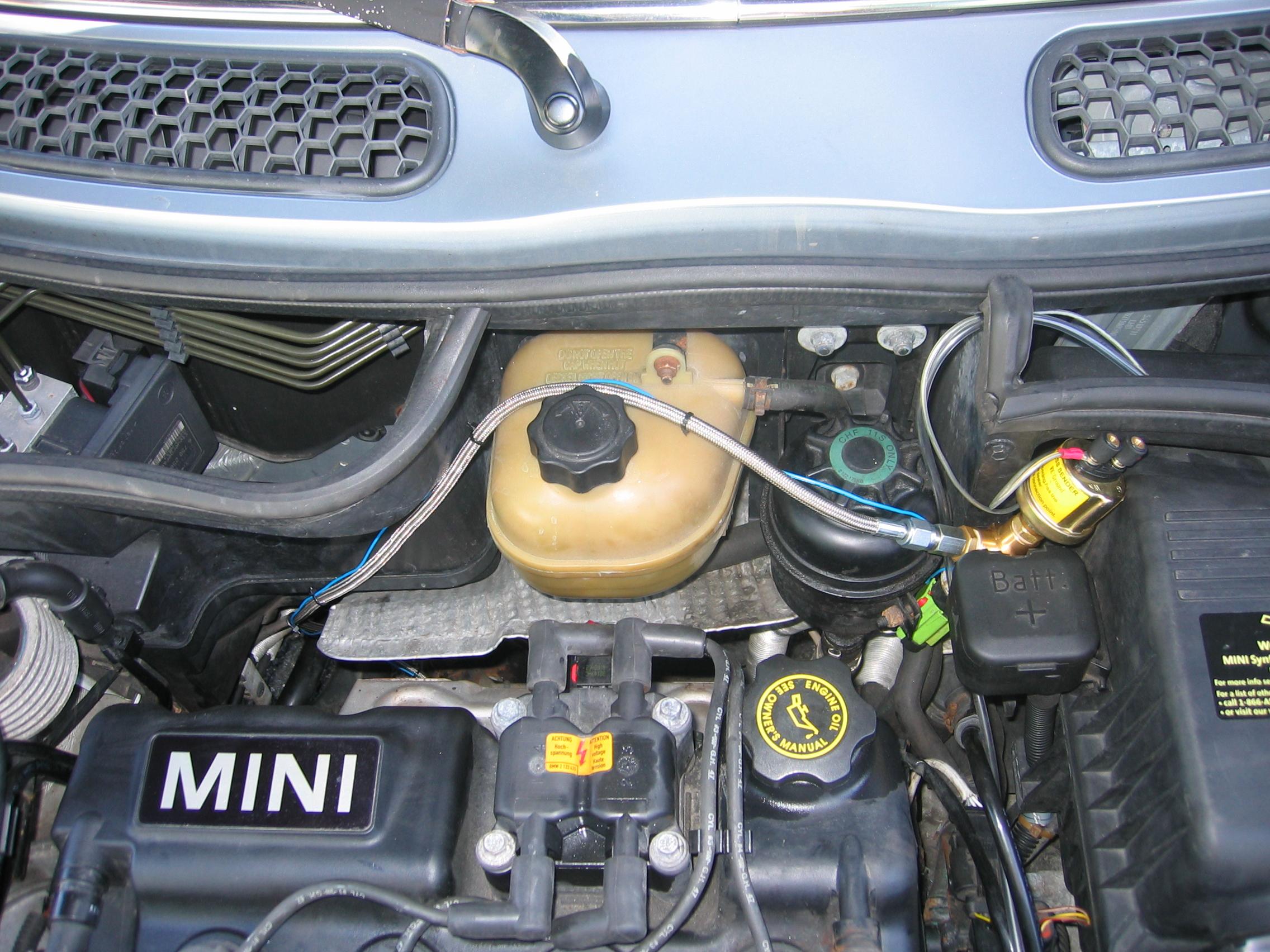

yea I plan on remotely mounting it with -4an stainless line. This is what plan on doing:
Block > 3/8m to 1/8f > 1/8m to -4an m > 3ft -4an hose > -4an m to 1/8f > 1/8m to 1/8m > 1/8f to 3/8m > 3/8 T w/3f > stock pressure sender on one and aftermarket sender on another with 3/8m to 1/8f

Finally got it all hooked up. I extended the stock sender wire and zip tied it to the braided line to prevent it from touching the exhaust manifold. This was the best location I could find for the T and 2 senders. It's wedged in there pretty firmly, I don't think its going anywhere.

That IS a good safe lookin / easily accessable job------you won't be sorry ! Did you just "pod" the gauge or???
