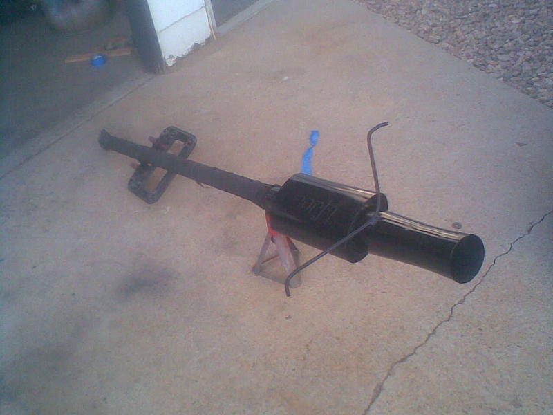

A while back before this thread fell off the map, I promised that I would post a better pic of my exahust when I got back up to Baghdad. Well I'm here and here you go, taken right after it was finished 15 minutes before instalation.
Nothing short of a 3" pipe with no muffler will out flow this baby, but this sounds WAY better.
. That sucker must me amazingly loud. I tried a catless dual 3" Burns stainless muffler system a couple years back and that was so bad the wife and I had ear plugs in on the way to AMVIV.That system lasted a week
.LB
Ya its a little loud (expetialy wilh no sound deadening goo left in the car) but I'm still young, and deaf from all the sterio compititions in highschool, my shooting hobby, 2 tours in Iraq, and all the other loud stuff ive worked/been around. It might be a little much when the RMW shorty goes on when I get home this time.
If it is I can always build something quieter

I've driven from Denver CO. to Nashville TN. with this exahust and it really isnt bad, it gets quieter if I throw a 50 pound duffell bag on the rear floor to keep it from vibrating, and roll the windows down a minimum of 2 inches, I dont know why but it helps.
It is nowehere near as loud as some of my friends V8's and Hondas, or my Samurai (but it only has a half of a glass pack on 2 feet of 2 1/4 and the Thorley header).
