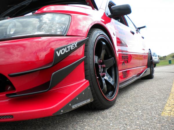

Fish you must be talking about theese(look at the pic)they are called cannards. Theese are on one of the EVO's that my buddy has tuned, they cost quite a bit from what he said.
The function of theese is to provide downforce to the front corners of the car, notice how they are placed in a area that sees alot of pressure not only from foreward movement but also what is being pushed across the front of the car.
The up side) They work, they are easy to produce,and they look cool IMO
The down side) Companys that make good ones are proud of them so they cost ALOT, I have seen them rip themselves from the car at high speeds due to bad mounting, a front spliter will do more theese just help, and MINI's dont have much of an overhang to use them.
I have been thinking of designs for months to make them work on the MINI, and the only thing I can come up with I actually need the car to design a template.
If you where to design some, you would want to square the front corners of the car with them. (To provide the largest surface area.) You also want the little buggers to go as far town the side of the bumper as possible, this even means going onto the fender flare right up to the wheelwell.(To maximize the ramp your low pressure area will form in to create your downforce.) And they need to be mounted solid, they will fall off if they are not.
Theese are the only major hurdles in your way, so go ahead and pioneer the way to a good fnnctional pice of personal genus you didn't know you had.
