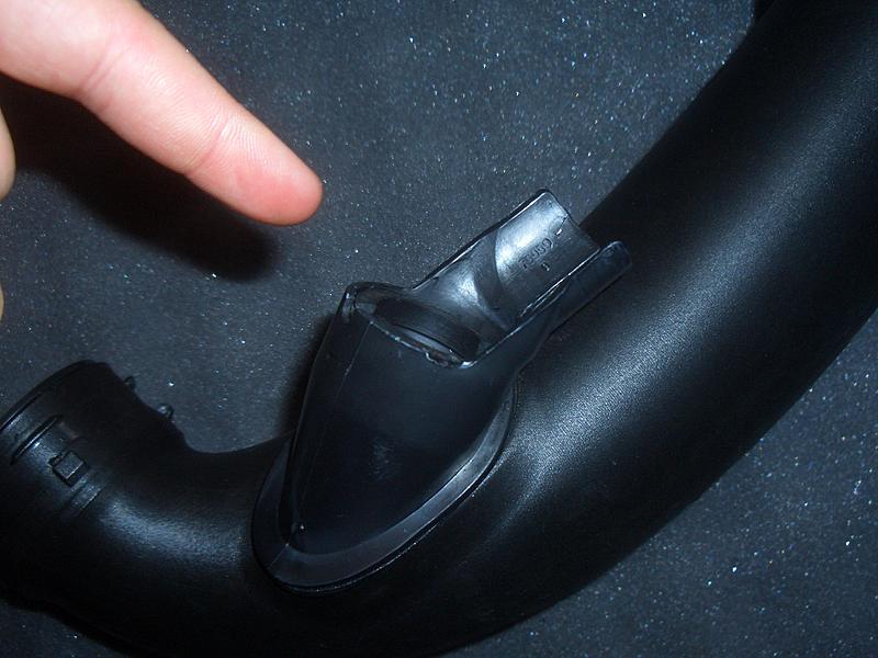

Also he gave me the turbo inlet pipe, That's swappable right? the only thing that worries me is this tab sticking out (pointing to it)
I'd rather have smooth wall turbo inlet pipe on there instead of the ribbed one.
also is there a larger opening on the JCW turbo inlet than on the stock S?
It's only an inlet difference of 2-3mm in size. If you take the rubber gasket thing out of your normal stock S inlet tube and replace the JCW inlet tube one with it, it works fine.
BTW - to use the inlet pipe properly you need to get the PCV tube that connects there to the valve cover for a perfect fit...or so I've heard
