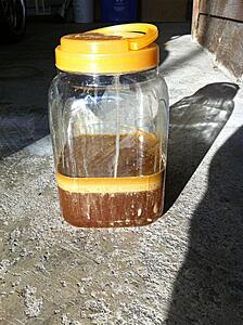

Third (3rd) drain on my BSH oil catch can:
Car info: 2009 R55 JCW
Current Date: 11/16/2012
Current Mileage: 13913 miles
Miles since Last Emptied: 3356 miles
Notes:
- summer driving produced very little water condensation, but provided approximately the same amount of oil residue.
- This time, the oil has a distinct gasoline smell, however is not extremely flammable.
- The semi-clear fluid is discolored (oxidized rust) water is on the bottom
- the tan separating layer is the result of a chemical reaction involving the oil vapor with water condensation
- the dark brown translucent fluid on top is the oil / gas mixture.
- Engine oil in crankcase was up to level at all times; no oil consumption to report.
Observation: very dry, hot and smoky summer in Colorado due to wildfires; car was driven on longer trips along with 20+ min daily grind to the office.
Thoughts: nothing new to report; steadily watching collection of fluids.
- Erik
