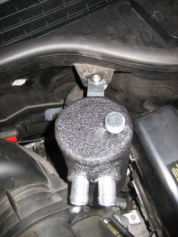

Oil catch can mounting weak????
Hey Gang,
Got my BSH oil catch can yesterday.
Went to install it today in the "traditional" location and only found a plastic tab that seems (to me) to be very flimsy. Granted, I do not have the hoses connected (which may make the can mor stable), but, still I am worried about the plastic tab breaking over time.
Whatchya think?

That is the tab that I used, had no issues. I would not lose sleep over it.

That tab is stronger than you think. Also the hoses are very sturdy and actually push against the OCC. I found that with the hoses attached everything was noticeably sturdier.

Right on everybody!!
Thanks for the quick replies!! I will leave it where it is! )

I have the same one, in the same location without issues. It'll be fine.
I concur. Once the hoses are in place you are fine. I would spend a few extra seconds to measure twice and cut once. Get proper tension without any sort of kinking on either hose. Pretty common sense stuff but just thought it would be worth mentioning.

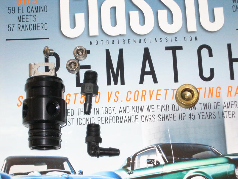

One more thing...I received 2 different sizes PVC intake connections...I am guessing that BSH sent both since this kit covers 2007 - 2011?

Additional fitting....
OK guys, this is a pic of the extra fitting/s I received (I assume to connect to the intake of different year models?).
No, the thin washer fitting goes into the driver side PCV port.
The wide fitting going into the intake tube.

So then the PCV hose on the passenger side will be completely removed? If so, wouldn't this leave a "hole" at each end (where the hose connected) and thus I would need 2 plugs?
No, the hose can stay; it mounts to the boost tap plug.

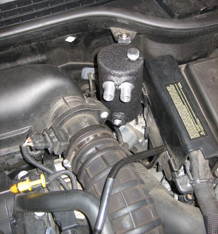

I was going to try to do a custom install of another vendors can until I saw this one on NAM.
The install was very simple and the parts seem to be of very high quality. I love this kit because you do not need to cut the factory PCV tube, and it doesn't neck down to 3/8 hose like the others.
I thought I was going to have to install the can on the firewall because the Alta intake locates the cold air tube right where the CC is supposed to go.
I did find a solution though. By moving the bracket down one hole (see first pic) I used some blue lock tite here to make sure it wouldn't spin with only the one bolt. I was able to use the tab on the fire wall. By mounting the CC bracket on the bottom side of the firewall tab I gained enough hood clearance. At the same time it raised the can up high enough to rest on the factory fresh air tube. I put a piece of rubber between the two.
I should note again that I only had a clearance problem because of the after market intake pushing the fresh air tube further to the right than normal.
Here is the can all installed
It's tight, but there's plenty of room so it doesn't rub (they say you don't need hose clamps here but it seemed too loose to me...)
The dual boost port was a cinch to install as well. I used the optional plug to divert the PCV gasses from both sources through the catch can, thus eliminating the need to run two. That is enough reason to buy it, but it also provides two boost sources if you need them. I already have the Alta boost tap for my BOV so I capped them both. I'll use them for future mods though...
So over all all I absolutely love this CC. I love the looks, I love the fact that I didn't have to cut the factory PCV tube. It was easy to install, high quality, baffled, and most importantly, takes care of booth PCV gas sources with one CC.

Looking at the boost tap, cannot see what you have used when building it up. I have the boost tap, a large threaded piece which screws in the end that fits in where the old PCV fits to the engine ie the boost tap side with o rings, see that the old hose clips on the back of this.
I now have three holes round the body. 2 same size and 1 smaller. Small one looks like it is where the securing clip mounts. Other 2 I can either fit straight connector or 90 degree connector which I guess are for a boost gauge, and a blanking screw. I guess I fit connector in one and blanking screw in the other although I am not using a boost gauge so do I need another blanking screw?
