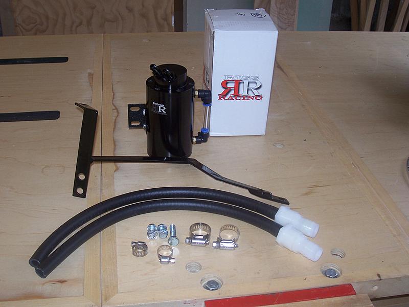

Hey Guys,
The catch can kit comes with the bracket you need. It is just a bolt on. Here is a photo I took that shows the bracket (with all the hardware). I'm selling mine as it won't fit using this braket with my Defenders of Speed CAI. I did a test fit when I had my DoS CAI out of the car (cleaning the filter) and the bracket works perfectly.
Cheers,
Greg

I have a dos cai and my catch can fits
Old Jan 28, 2010 | 04:47 PM
NAProf's Avatar
NAProf
iTrader: (7)
Posts: 108
From: Lewes, DE
James,
Yep, you certainly can put it in on the passanger side. I did that with the catch can I got from NM Engr. But if you want to use the bracket that comes with the RR kit it is set up to install to the drivers side of the OEM airbox.
Maybe one could cut and bend the provided bracket to use on the passanger side though - might have to think about that one.
Cheers,
Greg
