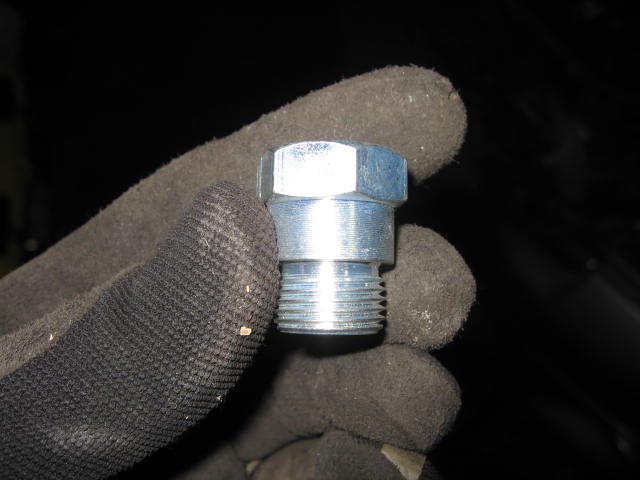

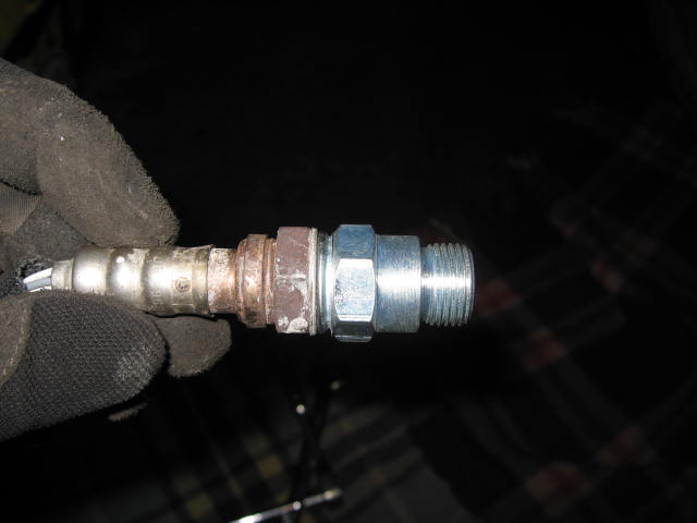

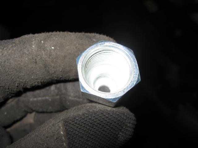

I just used one non fouler on the bottom sensor ( after cat ) , that fouler has one hole on the bottom. i picked it up in pep boys. i think one package contains 2 pieces.
Old Mar 10, 2009 | 04:21 PM
tintman718's Avatar
tintman718
Joined: Aug 2008
Posts: 230
From: New York, New York
So you didn't drill it? I'm guessing the reason people with other cars used two is because their O2 sensors are deeper then ours.
Old Mar 10, 2009 | 04:28 PM
MiniPOLACK's Avatar
MiniPOLACK
Joined: Nov 2008
Posts: 244
From: NYC baby
no its not that. people want to put the non fouler on the first sensor ( pre-cat ) which is way thicker and it wont fit that hole. in a first place, you dont need the non fouler on that sensor .
